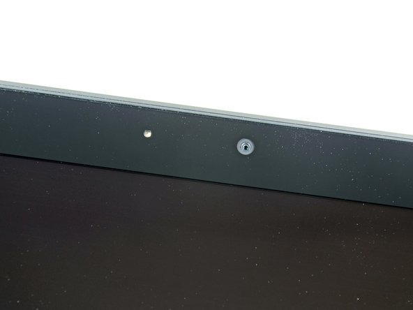

    • As we examine the device, the camera atop its sleek front stares back at us. The white dot to the left of the front camera is a notification LED.

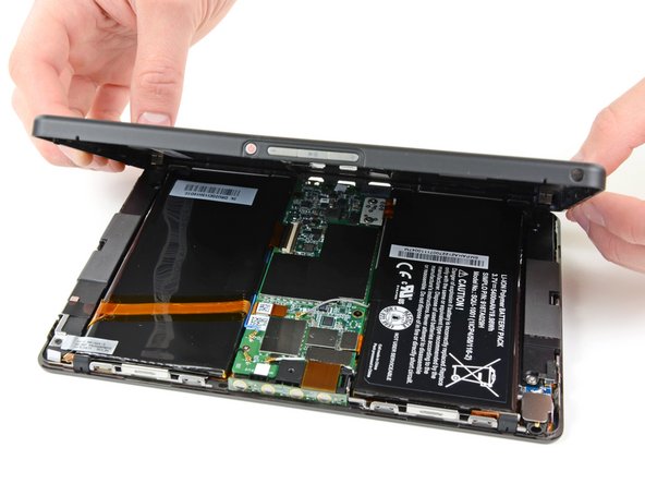

    • Upon releasing the clips surrounding the perimeter, the rear case can be removed.
    • Unlike other popular tablets, the PlayBook's guts are not housed within the back cover but are instead attached to the display assembly.
    • The PlayBook has a 20 watt-hour battery, which is a bit smaller than the iPad 2's 25 watt-hour and the Xoom's 24 watt-hour battery.
    • Even though the battery in the PlayBook has a smaller capacity, the battery life is rumored to be comparable to the iPad 2 and Xoom, although official numbers have not yet been released.

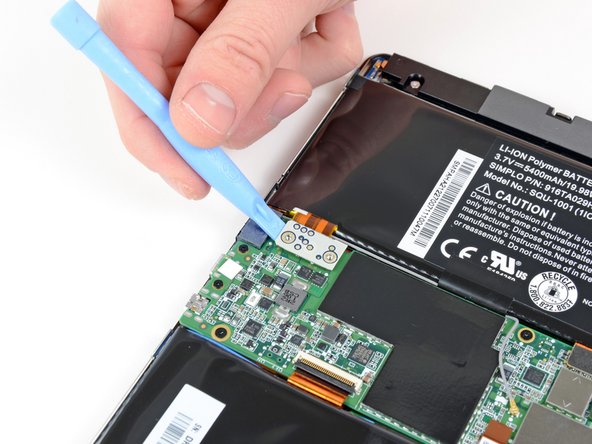

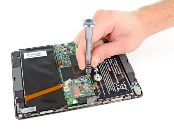

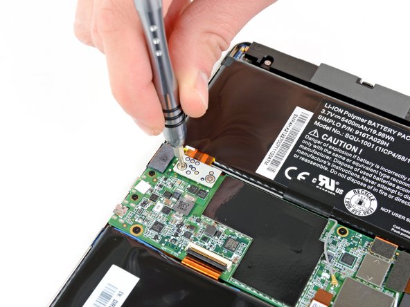

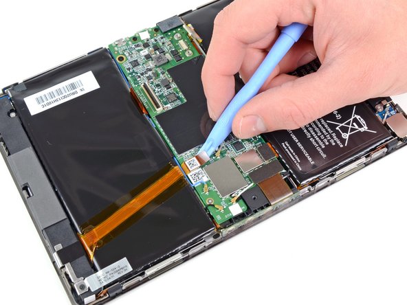

    • Now we can remove a pair of screws from the battery connector with a Phillips #00 screwdriver.
    • Next we pry off the battery connector to bring us one step closer to the goods.
    • We continue by prying off all the other connectors from the motherboard.
  6. BlackBerry PlayBook Teardown: step 6, image 1 of 2 BlackBerry PlayBook Teardown: step 6, image 2 of 2

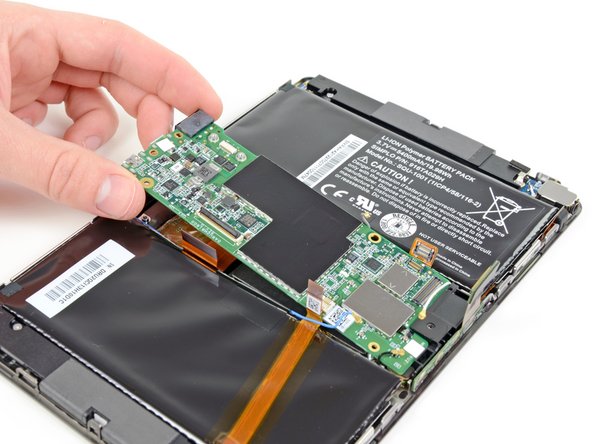

    • Next we remove a couple Phillips screws from the motherboard.
    • In an array of light showering us from the BlackBerry heavens (not pictured), we remove the motherboard from the PlayBook.

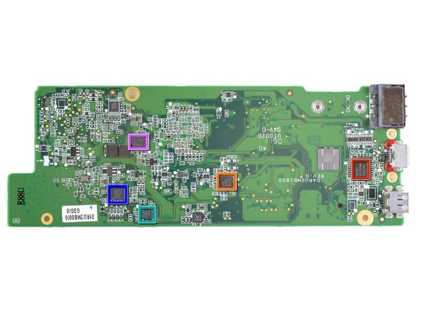

  7. BlackBerry PlayBook Teardown: step 7, image 1 of 1

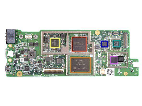

    • Front view of the motherboard. If you want the super-huge version of the motherboard, click here.
    • Elpida B8064B2PB-8D-F 1GB DRAM & the TI OMAP4430 1GHz dual-core processor
    • SanDisk SDIN5C2-16G 16 GB NAND Flash
    • Texas Instruments TWL6030 Power Management
    • STMicroelectronics XTV0987 5 MP mobile imaging processor
    • Wolfson WM8994E audio codec
    • Texas Instruments WL1283 GPS/WLAN/Bluetooth/FM
    • TriQuint Semiconductor TQP6M9002 802.11a/b/g/n + BT front-end module

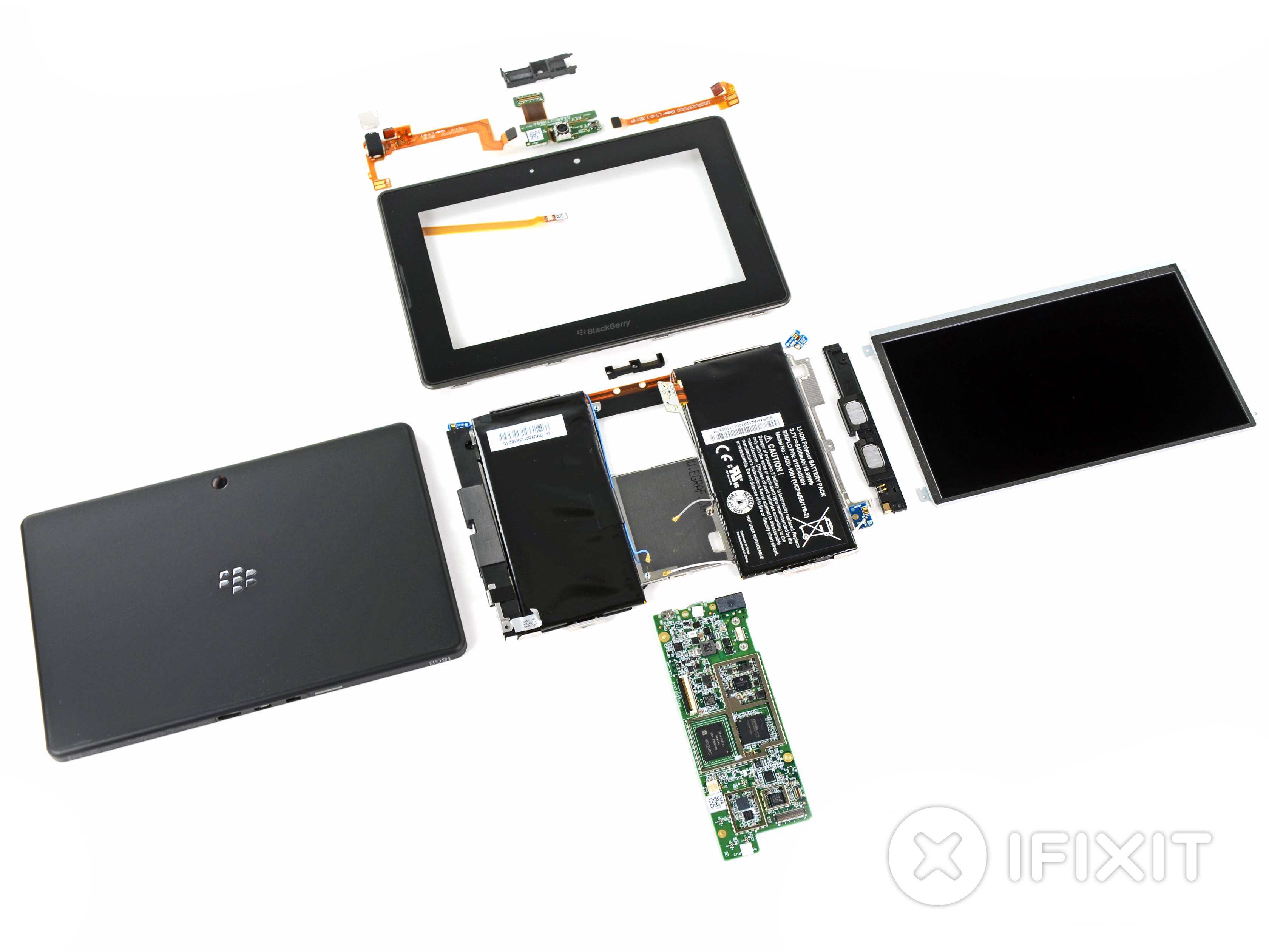

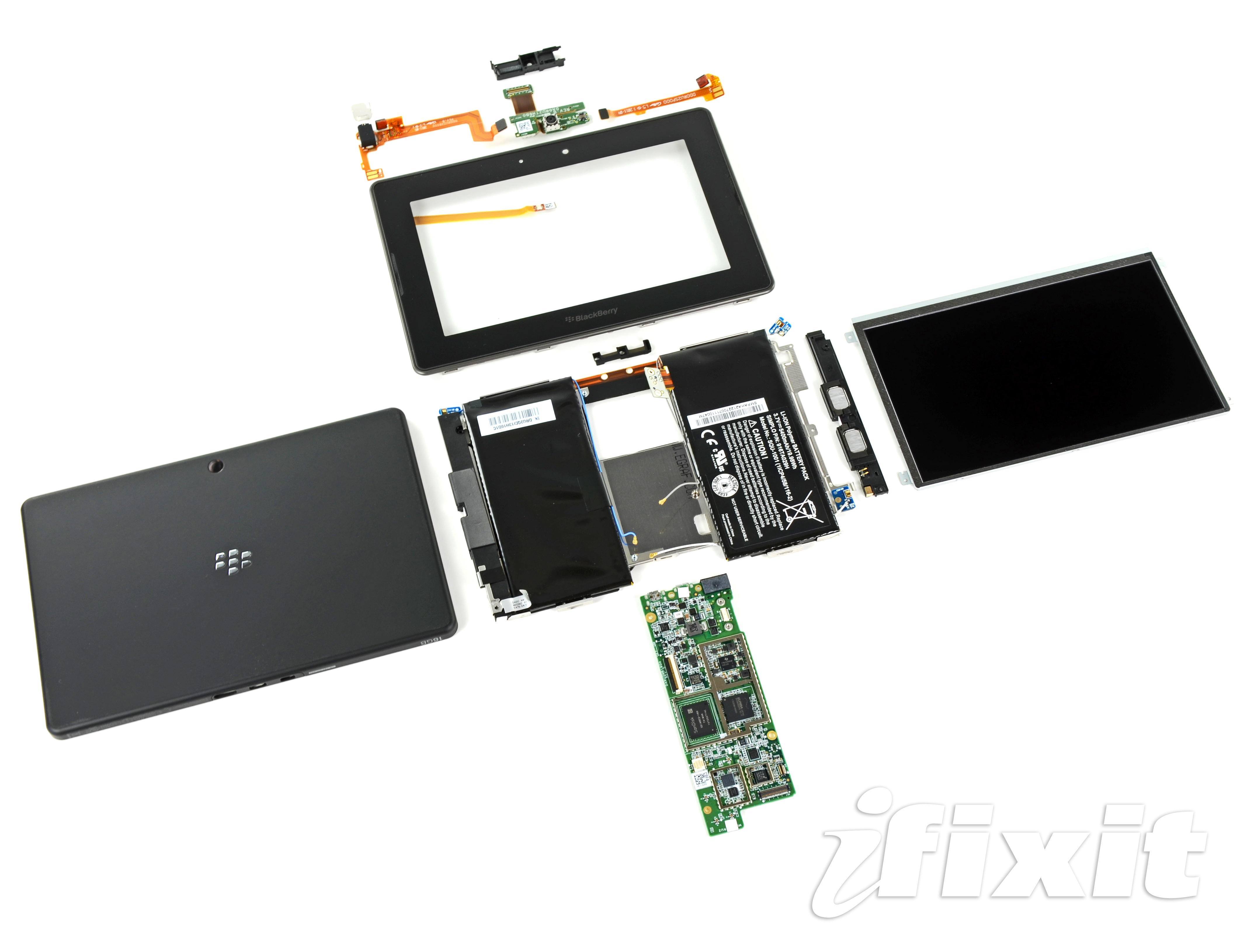

    • BlackBerry PlayBook Repairability Score: 7 out of 10 (10 is easiest to repair)
    • The rear cover comes off easily with a couple of pries from the plastic opening tool.
    • The LCD is not fused to the glass, making the glass repair easier on the wallet.
    • You have to dig through the entire device if you need to replace your cracked glass, but the mid-plane assembly comes out easily with all components attached.
    • Other components (cameras, headphone jack, etc.) come out easily. However, there are usually two or three components attached to the same ribbon cable, increasing replacement cost if only one component fails.
    • You'll need to remove the motherboard if you'd like to replace the battery -- which is glued to the mid-plane assembly.
    • Front glass panel has a metal frame glued to it, which you'll need to separate with a heat gun if the glass cracks.
