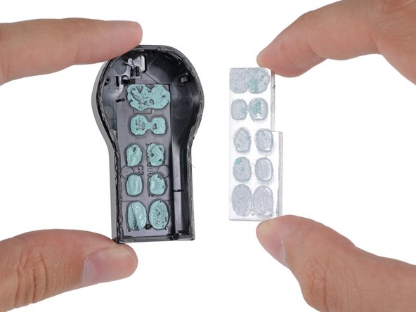

  5. Chromecast Teardown: step 5, image 1 of 2 Chromecast Teardown: step 5, image 2 of 2
    • The first thing out is, well, everything. Pulling the motherboard assembly out of the Chromecast leaves us with an empty shell.
    • Almost empty, that is, except for some excessive thermal leftovers and a big hunk of aluminum heat sink.

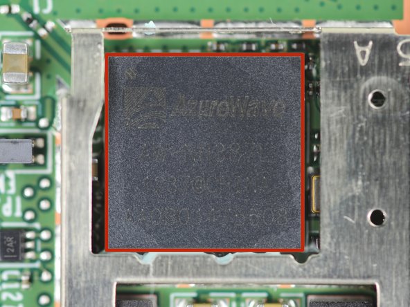

  6. Chromecast Teardown: step 6, image 1 of 3 Chromecast Teardown: step 6, image 2 of 3 Chromecast Teardown: step 6, image 3 of 3
    • The central nervous system:
    • AzureWave AW-NH387 802.11 b/g/n WLAN, Bluetooth and FM Combo Module
    • Marvell DE3005-A1 System on Chip
    • Micron MT29F16G08MAA 16 Gb (2 GB) NAND Flash Memory
    • Micron D9PXV 512 MB DDR3L SDRAM
    • DDR3L SDRAM (1.35 V) is a low voltage version of the DDR3 SDRAM (1.5 V).
