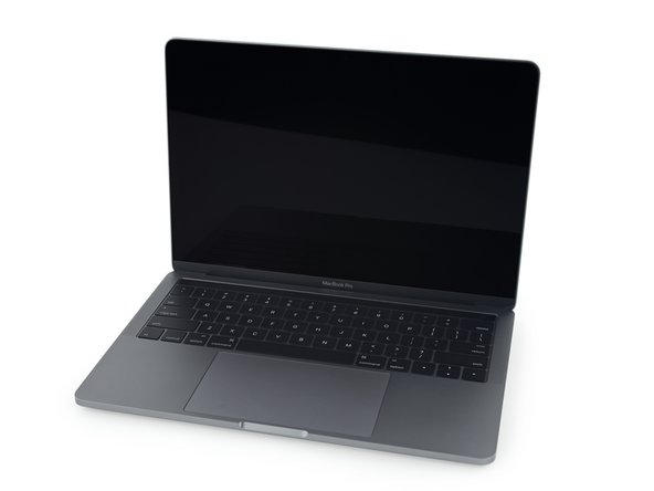

Today's million-dollar question: Is this a scaled-up version of the 13-inch "Escape Edition," or a scaled-down version of the 15-inch Touch Bar unit? Here's what the tech specs tell us:
13.3” LED-backlit IPS Retina display with 2560 × 1600 resolution (227 dpi), P3 color gamut
2.9 GHz Skylake dual-core Intel Core i5 (Turbo Boost up to 3.3 GHz) with integrated Intel Iris Graphics 550
8 GB of 2133 MHz LPDDR3 onboard memory (16 GB configuration available)
256 GB, 512 GB, or 1 TB PCIe-based SSD
Four Thunderbolt 3 (USB-C) ports supporting charging, DisplayPort, Thunderbolt, USB 3.1 Gen 2
Touch Bar with integrated Touch ID sensor
Force Touch trackpad

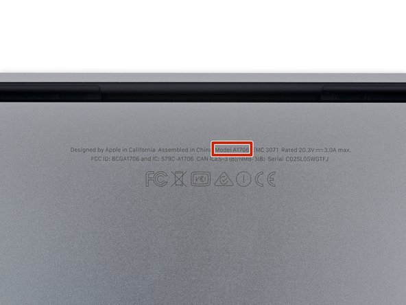

A rudimentary inspection of the outer case reveals the expected FCC certifications, and a new model number: A1706.

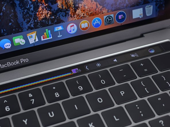

Do you miss your function keys? Hold down the Function key to see your missing function keys. Chameleon Mode, engage.
