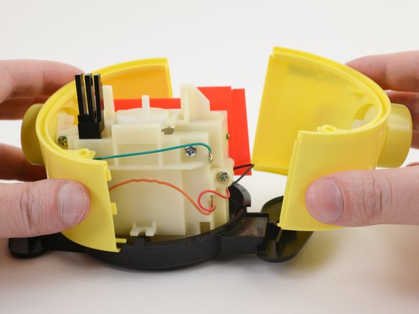

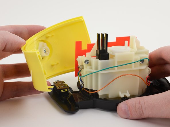

But enough reminiscing! Let's tear this thing down to see what makes Robie tick.

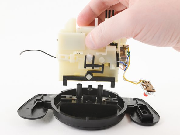

Unfortunately, the battery contacts are soldered to the motor assembly, so any repairs or replacement of the motor will require a soldering iron and some basic soldering skills to remove it entirely.
But once those two wires are removed, separating the motor assembly from the base is a cinch.
