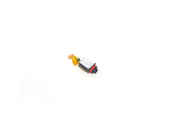

  11. Sony Xperia Z5C Teardown: step 11, image 1 of 3 Sony Xperia Z5C Teardown: step 11, image 2 of 3 Sony Xperia Z5C Teardown: step 11, image 3 of 3
    • Remove audio jack flex by flipping up the white locking tab of the connector base.
