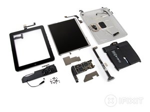

It's here! We got our hands on Apple's newest toy, the iPad, and we can't wait to see what's in it. So we won't— let's do this!
The iPad measures in at 242.8 x 189.7 x 13.4 mm and weighs in at 1.5 lbs.
The significantly improved 9.7 inch LED-backlit glossy widescreen with Multi-touch is perfect for all your movie watching, e-book reading needs.
The iPad's model number is A1219, which doesn't mean much. But the 3G iPad is A1337, which is rather geeky, even for Apple.
Yes, we did turn it on—how could we not? But then we turned it right back off and started figuring out how to pry this beautiful machine apart.
Insert a metal spudger between the display and the rear case to pry the iPad open.

Aaaand it's off. You have no idea how glad we are that this didn't require a heat gun.
Words from the wise: You might break some tabs getting the display assembly off.
The display has a marking referencing Honeywell patent #5280371.
It looks pretty barren, mostly because all the 3G equipment is missing.
The 3.75V, 24.8 watt-hour battery provides the juice for an advertised 10 hours of use. In contrast, the iPhone 3GS has a 4.51 watt-hour battery and the MacBook Air has a 40 watt-hour battery.
The USB power supply had to be enhanced specifically for the iPad. It's a 10W unit manufactured by Foxlink Technology, Ltd., part #A1357 W010A051.
Disconnecting the display data cable.
Removing these connectors is a two step process. You first have to flip up the locking bar (pictured) and can then slide the cable out of the socket.
The display data cable connector is the same style used in all of the new Unibody MacBooks.
Remove the EMI shield from the logic board, and presto!
This board is markedly different than the pre-production board we uncovered.

As always, the final layout shot.
Here's the weight breakdown: Aluminum back: 138 grams, Battery: 148 grams, LCD: 153 grams, Glass (and frame): 193 grams, Speaker: 17 grams, Main board: 21 grams, Everything else: 27 grams
Total: 697 grams (that's more than the .68 kg Apple quotes, has anyone else weighed their complete iPad?)
