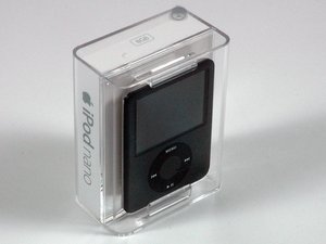

    • There it is, in the same style box as the last Nano, but quite a bit shorter and wider.

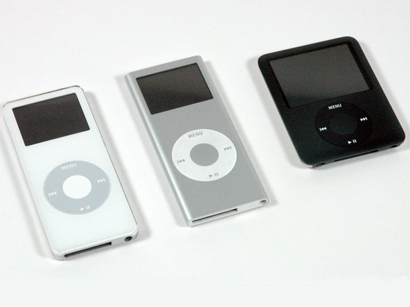

  3. iPod Nano 3rd Generation Teardown: step 3, image 1 of 1
    • The growing iPod Nano family.
    • Although the new Nano is shorter and wider than its older siblings, it has approximately the same area (36 square centimeters).

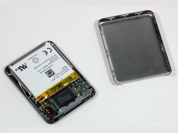

  5. iPod Nano 3rd Generation Teardown: step 5, image 1 of 1
    • And here's our first look inside this newest Nano.
    • The case has eight locking tabs:
    • Three on the left, evenly spaced.
    • Three on top.
    • Two on the right, near the bottom, to make room for the display circuitry at the upper right.

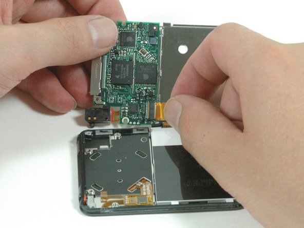

  7. iPod Nano 3rd Generation Teardown: step 7, image 1 of 1
    • We've disconnected the click wheel cable and flipped the board over to disconnect the display cable.

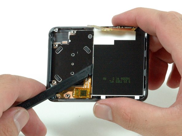

  8. iPod Nano 3rd Generation Teardown: step 8, image 1 of 1
    • Now we use a spudger to pry up the display, which is held along the case's edge by an adhesive strip.
    • The first generation Nano's display was attached in exactly the same way. If you're not careful when prying it up, you may crack it.

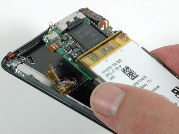

  10. iPod Nano 3rd Generation Teardown: step 10, image 1 of 1
    • Here the battery is out of its metal housing, which is attached to the logic board by, that's right, adhesive.
    • The battery is attached to the logic board by three through-hole solder points, as in the second generation Nano (sorry, no easy replacements).

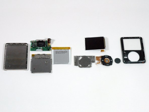

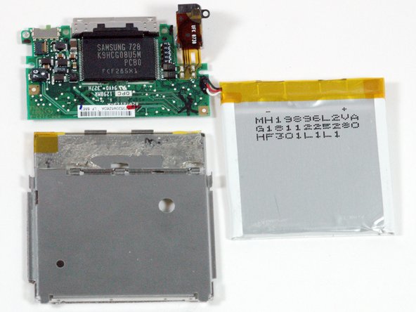

  11. iPod Nano 3rd Generation Teardown: step 11, image 1 of 1
    • And here's everything together again, but apart.

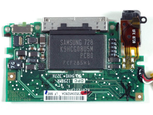

  12. iPod Nano 3rd Generation Teardown: step 12, image 1 of 1
    • A close-up of the logic board's top, which sports an eight gigabyte Samsung flash memory chip and headphone jack.
    • The headphone jack is soldered to the logic board, as in the first generation Nano, but not in the second.

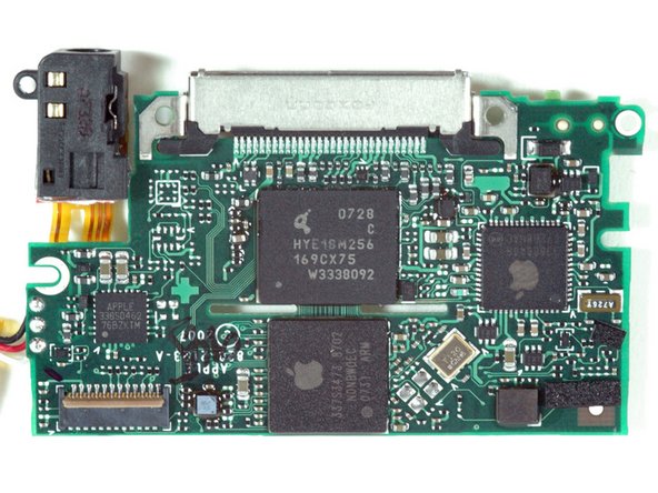

  13. iPod Nano 3rd Generation Teardown: step 13, image 1 of 1
    • A close-up of the logic board's bottom.

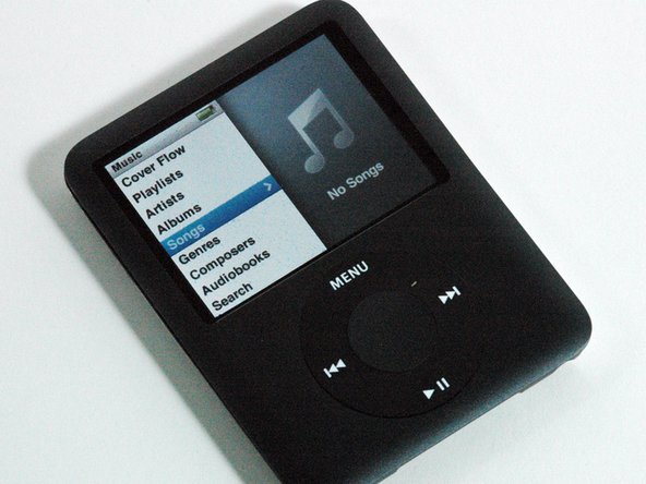

  14. iPod Nano 3rd Generation Teardown: step 14, image 1 of 1
    • And it still works! Now, having satisfied our curiosity, we can put some music on it.
