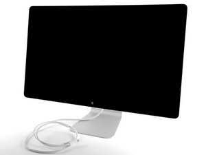

How can I fix my display blacking out intermittently?
I've had the Apple Thunderbolt Display for a little more than a year, and it has started to intermittently go black for a few seconds at a time. When it does, I usually lose connection to my usb devices connected through the display. If I let it go on, it blanks more and more frequently until the system kernel panics.
So far, I've tried cleaning the contacts with rubbing alcohol. This made them more visually attractive, but did not solve the problem.
Second, I tried using another macbook pro, but it had the same issue.
I've noticed that the thunderbolt connector heats up significantly when it's in use. I'm wondering if there's a heat-related issue that could be causing a broken connection in the electronics inside the connector. Any thoughts?

I have found that the All-In-One Cable goes bad and results in an intermittent blacking out. I have had to replace mine every 12-18 months.
by
I had the same problem, and it grew worse with time. The issue was the Thunderbolt cable failing just behind the computer thunderbolt connection, right where the cable protector terminates. Had the same issue with an IPad Thunderbolt powersupply cable. My gripe is that replacing the power/data cable for the display is a tedious and challenging task. A simple plug on the back of the monitor as other manufactures use would have been good, but noting that Apple does not sell the cable, my guess is that Apple wants the user to have to buy a new monitor. Sad way to do business.
by
After having the intermittent blackout problem on my Thunderbolt display for years it seems that I have fixed it by replacing the cable. I made sure that the problem was indeed the built-in monitor cable by bypassing it completely using a normal thunderbolt cable plugged into the expansion thunderbolt port on the monitor (yes the monitor can be used this way, as long as you don't require another thunderbolt port for other devices), making sure that the problem was not with the thunderbolt port on my laptop. Well, I need that thunderbolt expansion port, so I bought a replacement cable on eBay ($23!). I did not need to buy the recommended pair of suction cups to pull the glass off of the display, I used a single GoPro suction camera mount, positioning it near the top left corner, it pulled the glass free with no drama-inducing excess force needed.
So to sum up, from my experience anyway, it's the cable. Not the firmware, not the power supply.

The heat is expected as the Thunderbolt cable has some electronics in the connector which does heat up.
I would focus on the power supply in the display. Heres a similar Question Why is my LED cinema display switching on and off?

Using another Thunderbolt cable attached to the additional port on the display instead of using the built in cable solved the problem for me. At least I now know that it is the display cable and not something with my Macbook. Now I will get a replacement cable for the display. Can anyone tell me if it can be opened without suction cups, or are they necessary? Thanks.

using a separate Thunderbolt cable fixed the issue for me.
by
After testing in three different monitors and a couple more cables got it working upgrading my miniDP-DP cable to a HBR2 ("High Bit Rate 2") compatible cable. StarTech.com MDP2DPMM1M

There was a firmware update that fixed the problem

Unfortunately I’m in a “throw it out or fix it” situation with this. My TB Monitor situation started to happen more often, and on a few occasions became a crisis as I can’t do my work without a second monitor (film editor). I bought a new Dell 3219Q monitor to replace it, but since the TB monitor does indeed work 98% of the time, I would love to find a way to fix this issue so I can have a large dual monitor setup. I know that, at least in my case, along the way I’ve disproved all the theories in this thread, including my own.
Here are things I know:
• If power to the TB Monitor was turned off for a while (overnight, typically), the issue would almost always happen - the computer would ‘see’ the monitor, all functions and things hubbed through the monitor would work just fine, but the display was black.
• I changed ports, cables, adaptors and finally even the computer, using a brand new MacBook Pro, but the problem continued no matter what I did.
• It’s not a software or firmware issue, either with the monitor (it has that last firmware update) or computer (because it happened with a different, brand new computer, running Apple’s off-the shelf Catalina instead of Mojave on the older computer).
• Once, the monitor just went black during the day as I was working. Everything continued to work just fine, but the display was completely off.
• Pulling the power to the monitor for at least 20 mins or more was the ONLY thing that could bring it back to life, but doing this for hours did not guarantee it coming back. In every case that the display has gone black, it has eventually ALWAYS come back - at some point. But I’ve had to leave it alone for a day or two to get that. Suddenly, it would just work.
•  I just went back to using the built-in cable ganglion and that works, and fails, just as much as a direct cable in into the back of the monitor did.
• I removed absolutely everything plugged into the back so there is no power draw other than monitor.
Given all the above, I didn’t bother installing the new laptop power/TB cable ganglion I bought here, as that’s clearly not the issue.
