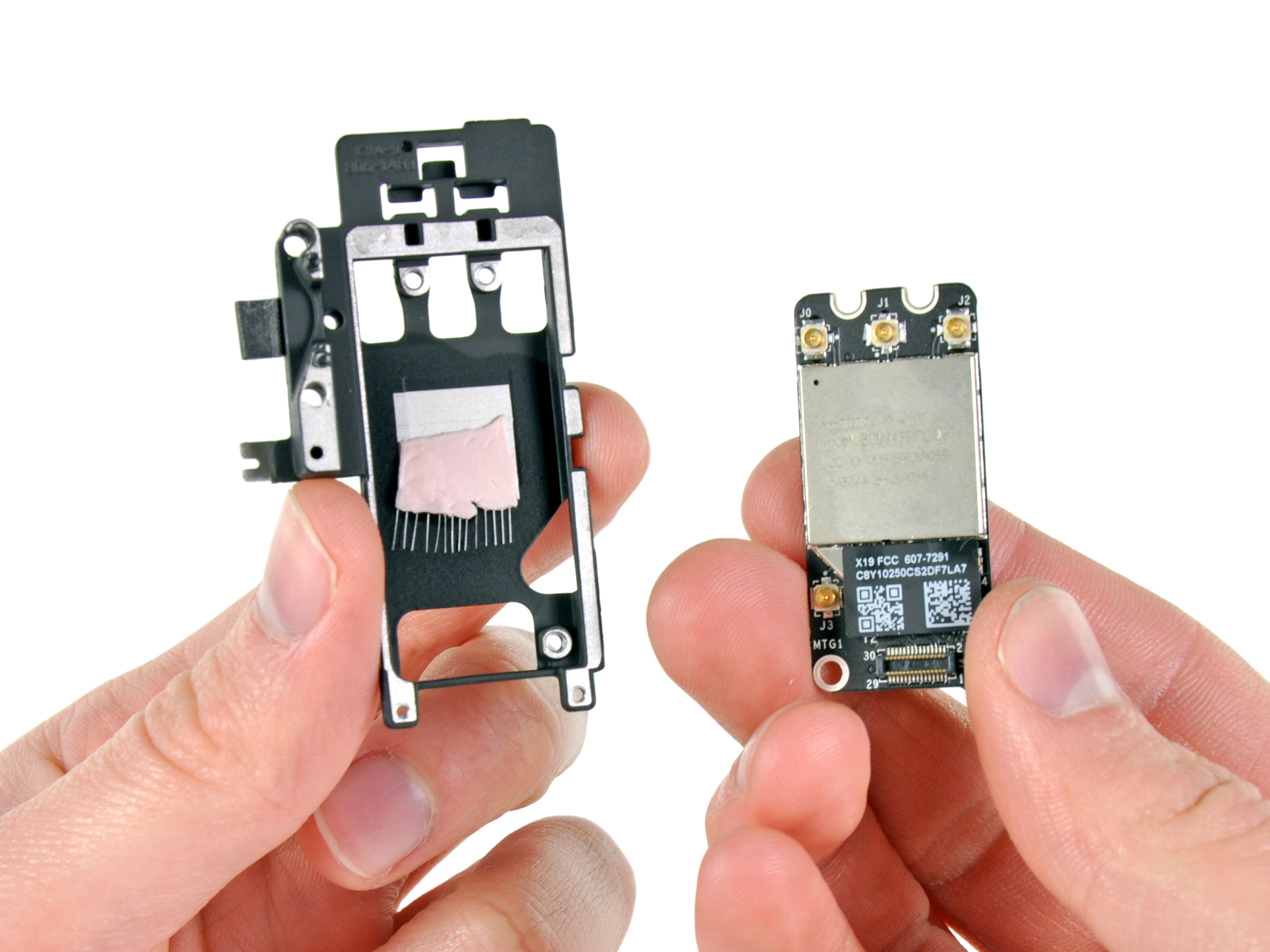

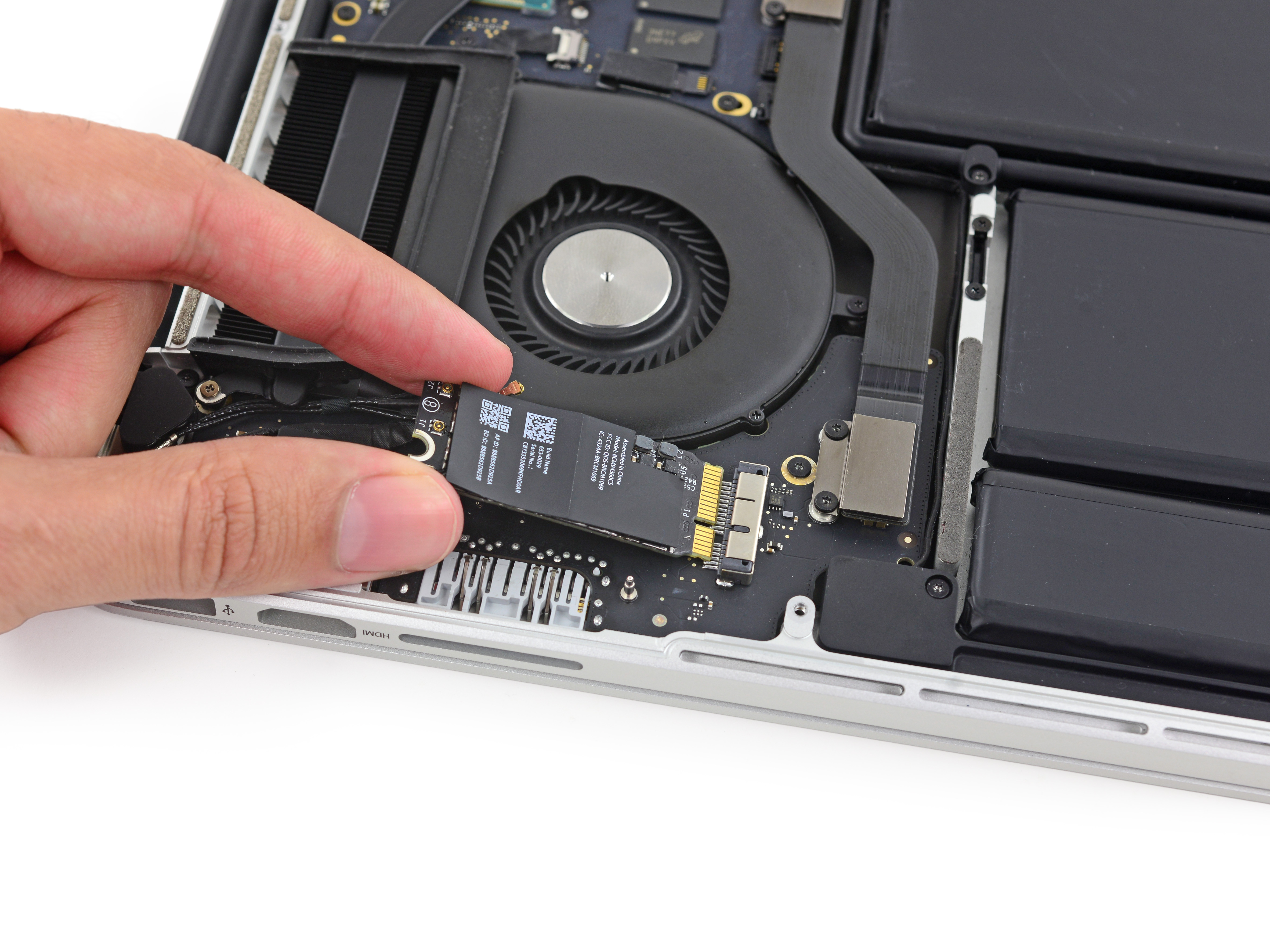

Sadly Broadcom stopped production the AC version of the Combo board your system requires. The parts run was short as Apple altered its design in the next model series. Here's what yours looks like: 13" MacBook Pro 802.11n AirPort bd and the newer model: 13" MacBook Pro 802.11ac AirPort bd. Note the differences in the connector interface.
