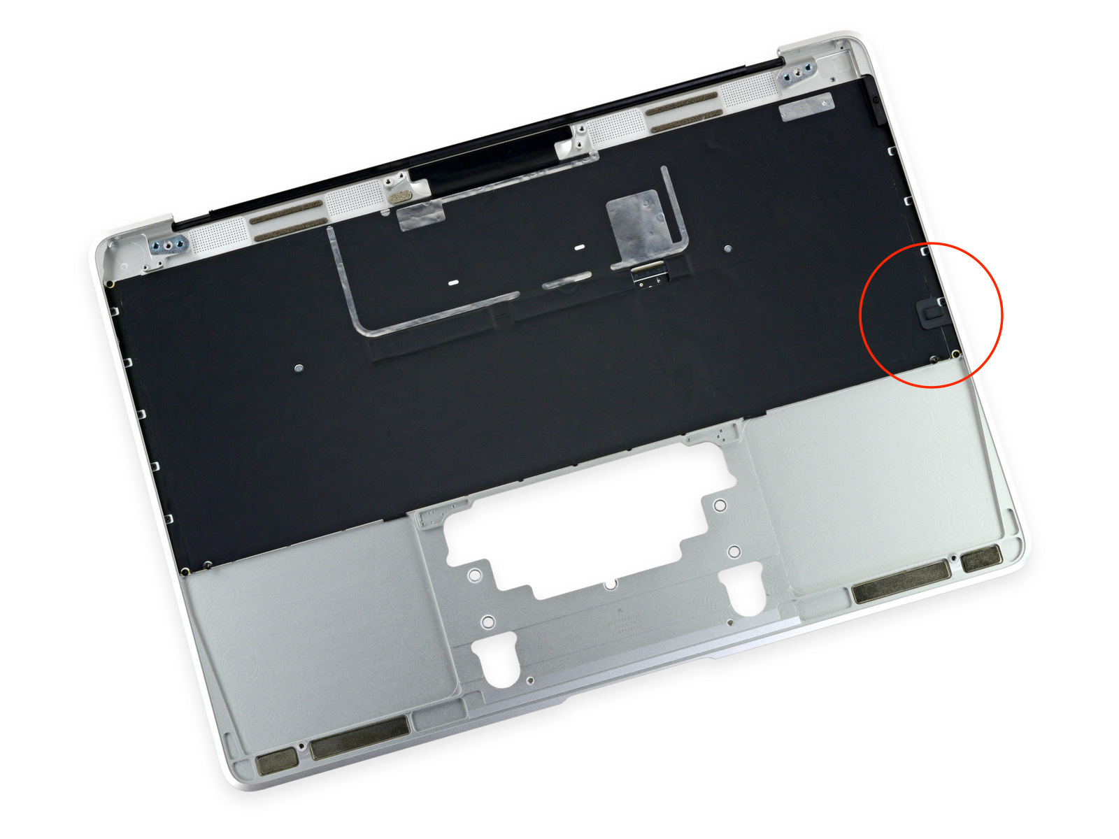

You'll need to do some sleuthing! You'll need a magnet and some steel paperclips. Hopefully you can get the system to alter its state.
Take the paperclips and slide it down on the inside surface of the lid around the side and top edges they should stick to the magnets that are located on the lid. Carefully, fold down the display so you can reference the location on the uppercase when the magnets hit. Now try your magnet sliding it on the uppercase when the clips where to see if you can find the Hall effect detectors location (a wax pencil marker might help). One of the magnet locations should cause the the display to turn off. In any case it will give you an idea where to look for the hall effect sensor within the system.
If you review the older Unibody 15" hard drive cable we can see the Hall sensor (marked in Red):
So it can be well hidden! I've not serviced this system yet so I can't tell you were its hidden.

Yeah I understand I've got plenty of cables I can find one. apart from a trackpad replacement and the repair of water damaged boards this is the first problem I've came across with that can be solved quick, I gave something similar to your idea stated above ago but the machine will not respond to anything the second the device is on, the lid thinks its closed I had a go at absoutly gutting the machine including the horribly adheared battery and can't find anything in the top case I'm going to take a look at the hinge mechanism as this is the only other place I can think, if it helps you to answer the problem the device still switches on automatically when the lid is opened which I thought it shouldn't do if there is a sensor faulty or something.
by
https://d3nevzfk7ii3be.cloudfront.net/ig...
Im going to take a look in this area too just incase its similar to the 12 inch
by
That would to a magnet! Not the sensor. The sensor needs to be wired back to the logic board. I wouldn't put it past Apple to do a switch-a-roo on us putting the sensor in the lid and the magnet in the uppercase! Does the location you marked appear to be a magnet?
by
