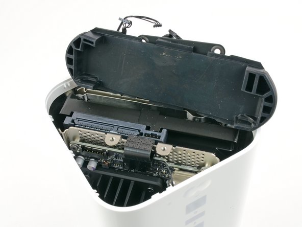

    • Alright, first thing's first: opening this enchilada. The procedure's the same, so I won't bore you like last time.
    • Now that that's out of the way, on to the good stuff: as soon as you open the Time Capsule, you notice subtle differences.
    • Instead of a metal cover/clamp, now there's a smaller metal cover/clamp that hugs a rubber cover like a... you get the idea. Underneath that rubber cover lies the hard drive.

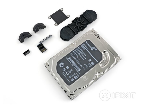

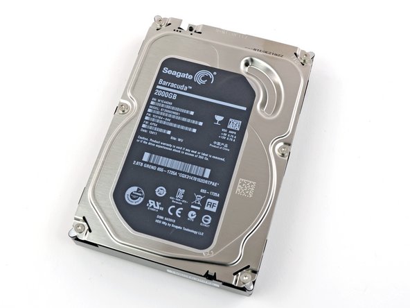

    • The drive is a standard, off-the-shelf Seagate Barracuda drive. We're cheapskates (hey, you never know when you might kill a $3,000 Retina MBP while trying to open it), so we opted for the 2TB option.

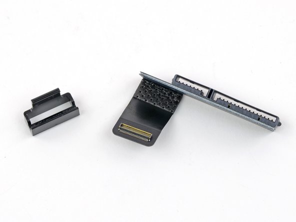

    • The standard SATA drive has a not-so-standard, super-thin connector that attaches it to the mothership motherboard.
    • The SATA cable's super-thin profile allows the hard drive to be plugged in, as well as allowing it to be clamped securely into the enclosure via the rubber cover (and metal clamp).

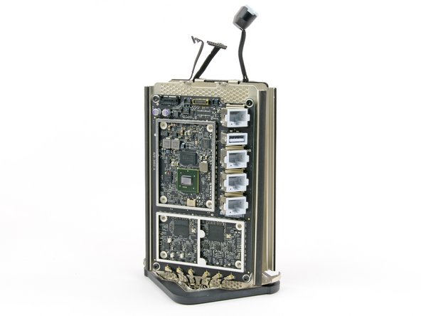

    • This is where the magic happens. This port is missing from the AirPort Extreme of yesteryear, which allows the Time Capsule to be a Time Capsule, and the AirPort Extreme to be... well... not so extreme.
    • Folks asked us if it's feasible to make an Extreme into a Time Capsule. Theoretically, the answer is "Yes," but we're not sure why you'd go through the trouble — the Seagate Barracuda drive is essentially the price difference between the Time Capsule and the Extreme.
    • Protip: You might as well pony up the additional dough ahead of time, and save yourself the potential of bricking the device.

    • Aside from that, the Time Capsule is pretty much identical to the Extreme. The same power supply, fan, and processing juice.
    • Basically nothing new to see here, move along.

    • Quick update: the Time Capsule will easily accept a 4TB 3.5" hard drive in place of its lowly 2TB original drive. The Seagate was used to take this screenshot, but the HGST drive should work fine as well.
