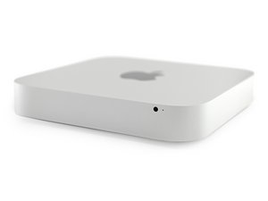

    • Apple's "affordable powerhouse" offers a range of hardware configurations (but no gold color option, so you can't configure for bling). Our unit's internals include:
    • 1.4 GHz Dual-Core Intel Core i5 (Turbo Boost up to 2.7 GHz) with 3 MB L3 cache
    • 4 GB of 1600 MHz LPDDR3 memory
    • 500 GB Hard Drive
    • Intel HD Graphics 5000
    • 802.11ac Wi-Fi + Bluetooth 4.0
    • OS X Yosemite

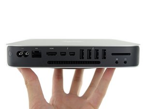

  2. Mac mini Late 2014 Teardown: step 2, image 1 of 2 Mac mini Late 2014 Teardown: step 2, image 2 of 2
    • The backside of the mini remains almost identical to the previous iteration. The only change is the omission of a FireWire port in favor of an extra Thunderbolt 2 port.
    • The Mac mini Late 2014 retains the model number identifier of A1347, but is distinguished by the EMC number 2840.

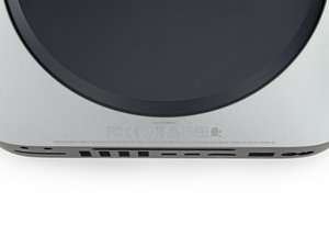

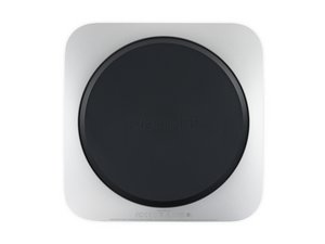

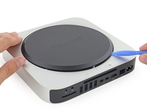

  3. Mac mini Late 2014 Teardown: step 3, image 1 of 3 Mac mini Late 2014 Teardown: step 3, image 2 of 3 Mac mini Late 2014 Teardown: step 3, image 3 of 3

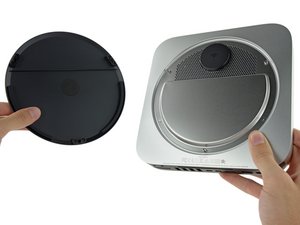

    • Gone are the handy thumb indents and indicators. This mini doesn't appear to have twist-off bottom cover!
    • We've got a bad feeling about this.
    • A flick of our bottle opener plastic opening tool pops this (lower) cap off.
    • Well that was nice! But now we're greeted with something new: a solid door where there was once handy access to the RAM and fan.
    • We're starting to feel like the locks on our apartment changed and we weren't given the new keys...

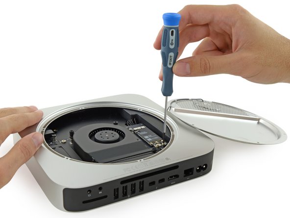

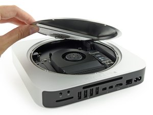

  4. Mac mini Late 2014 Teardown: step 4, image 1 of 2 Mac mini Late 2014 Teardown: step 4, image 2 of 2

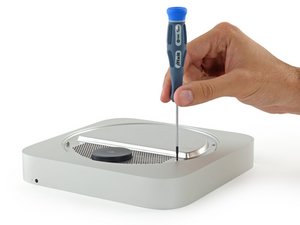

    • Time to break down the door and see what's changed inside. The plastic bottom cover snaps onto three screws—three TR6 Torx Security screws. Really? Rude.
    • This is the smallest Torx Security screw we've ever seen—our kits go down to T7 Security, so we asked our tool design team to get improvising.
    • Improvisation complete! Our packrat engineers produced a lone prototype T6 Torx Security screwdriver, a tool we originally abandoned because nobody had seen such a screw used in real life
    • Thanks, Apple.
    • We'll get this ridiculous driver in the store shortly.

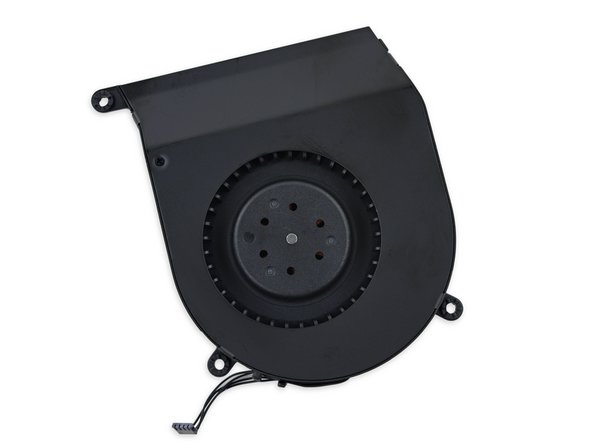

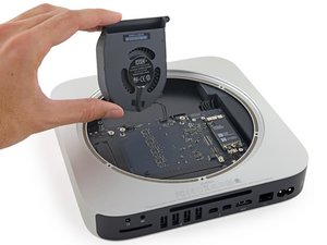

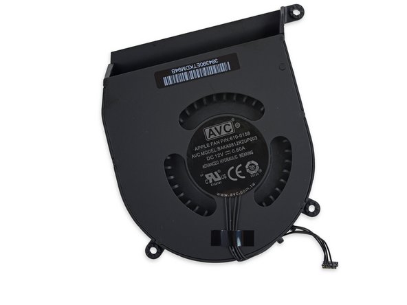

    • Upon removal, the fan seems identical to the one from the previous model—but let's not be too quick to judge a fan by its cover.
    • Advanced Hydraulic Bearing
    • Hmm. Interesting. What exactly is Advanced Hydraulic Bearing? Let's find out. According to Asia Vital Components:
    • AHB "consists of a polished steel shaft, a sintered bearing and fluid lubricant." In this system there "is no contact between shaft and bearing" and thus "the bearing load is carried solely by a film of fluid lubricant."
    • AHB is best for fans that operate at a lower speed. It's better at absorbing shock and dampening vibration than traditional ball bearings, making for a quieter fan.

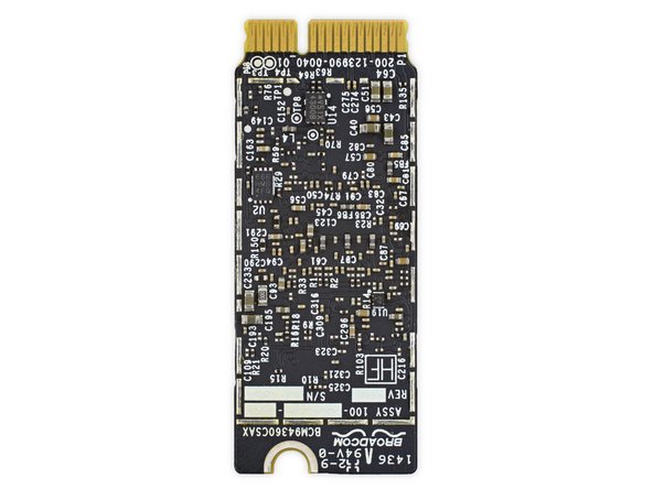

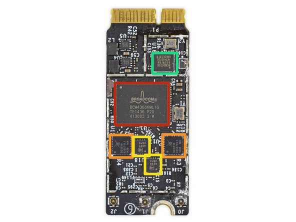

    • The AirPort card is dispatched after removing one screw and disconnecting two more antennas from their sockets.
    • Gone is the funky cable-connected AirPort card of yesteryear, this AirPort card is now full-fledged PCIe, supporting Wi-Fi ac.
    • Let's take a look at the ICs found on the AirPort card:
    • Broadcom BCM4360KML1G 5G WiFi 3-Stream 802.11ac Gigabit Transceiver
    • Skyworks SE5516 Dual-Band 802.11a/b/g/n/ac WLAN Front-End Module
    • RF Micro RFFM4293 2.5 GHz FEMS and RFFM4591 5 GHz FEMS
    • Broadcom BCM20702 Single-Chip Bluetooth 4.0 HCI Solution with Bluetooth Low Energy Support

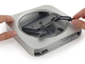

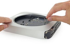

  8. Mac mini Late 2014 Teardown: step 8, image 1 of 3 Mac mini Late 2014 Teardown: step 8, image 2 of 3 Mac mini Late 2014 Teardown: step 8, image 3 of 3
    Tool used on this step:
    Mac mini Logic Board Removal Tool
    Buy

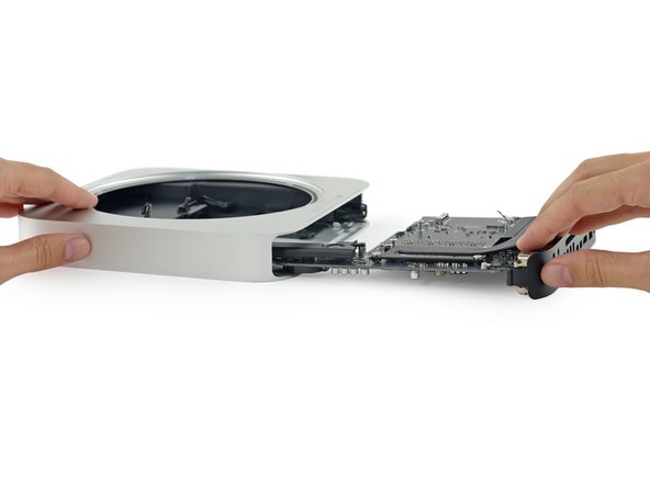

    • Using our handy hand-powered Mac mini logic board removal tool, we handily remove our Mac mini's handsome logic board.

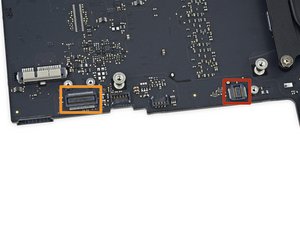

    • While past Mac minis have featured two SATA ports, allowing users to upgrade their base model with an extra hard drive, this year we only get one.
    • However, this empty socket over here may well be a spot for a PCIe cable, enabling the installation of a blade SSD.
    • More on this once we get our hands on a Fusion-equipped Mac mini.

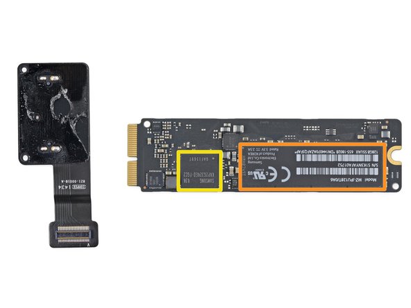

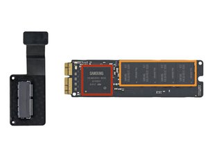

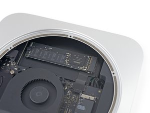

  9. Mac mini Late 2014 Teardown, Update: step 9, image 1 of 3 Mac mini Late 2014 Teardown, Update: step 9, image 2 of 3 Mac mini Late 2014 Teardown, Update: step 9, image 3 of 3

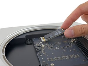

    • True to our word, we cracked open a Fusion drive equipped Mac mini, and it looks like our suspicions were accurate.
    • The empty connector is now filled—by a PCIe cable, glued to the top of the hard drive tray.
    • The SSD matches the one we found in the MacBook Air 13" Mid 2013 with the same chips:
    • Samsung S4LN053X01-8030 (ARM) flash controller
    • 8 x Samsung K9LDGY8SIC-XCK0 16 GB flash storage
    • Samsung K4P2G324ED 512 MB RAM

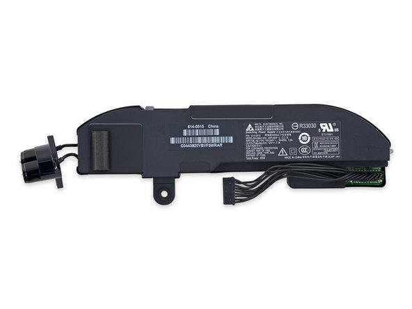

    • We've got the power (supply) at the tips of our fingers. It's an easy extraction, even if it took a while to get here.
    • We get a slight rush before we realize it is the same as the 2012 model...which was the same as the 2011 edition.
    • In the immortal words of Gertrude Stein, "This is the lesson that history teaches: Repetition." (Put another way: Apple doesn't fall far from the tree.)

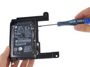

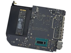

    • Before we go, let's pull out the hard drive tray and take a look at the platter drive our mini came loaded with.
    • Tucked under the tray: a 500 GB, 5400 RPM HGST hard drive, coming in at 2.5" wide and 7 mm thin.
    • And on the top of the tray, a promising mounting point for a blade-style PCIe SSD, presumably what we'll find in a Mac mini equipped with Fusion Drive.
    • To test just how promising, we dropped in the SSD from our recently torn down 27" Retina 5K iMac (and used its mounting screw). Looks like a nice fit!

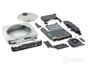

    • Mac mini Late 2014 Repairability: 6 out of 10 (10 is easiest to repair).
    • There's no glue anywhere inside that needs to be removed while disassembling the mini.
    • With the proper tools, disassembly is straight-forward and simple.
    • T6 Torx Security screws are intended to lock you out of your mini, and make it hard to clean the fan or replace the hard drive.
    • The CPU is soldered to the logic board and not user-upgradeable.
    • The RAM is now also soldered to the logic board, and not user-upgradeable.
