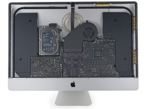

    • How do you herd together 14.7 million pixels? You can ask nicely, or you can brandish some heavy-duty hardware. Inside the Retina 5K iMac:
    • 3.5 GHz quad-core Intel Core i5 processor, with Turbo Boost up to 3.9 GHz
    • 8 GB (2x4 GB) of 1600 MHz DDR3 RAM
    • AMD Radeon R9 M290X graphics processor with 2 GB of GDDR5 video memory
    • 802.11ac Wi-Fi + Bluetooth 4.0
    • PCIe-based SSD storage and SATA hard drive

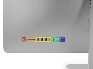

    • Not one to waste a good model number on just a single device, Apple again recycles A1419.
    • For a unique identifier, this is EMC 2806.
    • At the rear of the iMac, we find a plethora of I/O ports and a lone SDXC card slot:
    • Headphone jack / Optical digital audio output
    • SDXC card slot
    • Four USB 3.0 ports
    • Two Thunderbolt 2.0 ports
    • Gigabit ethernet port

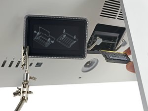

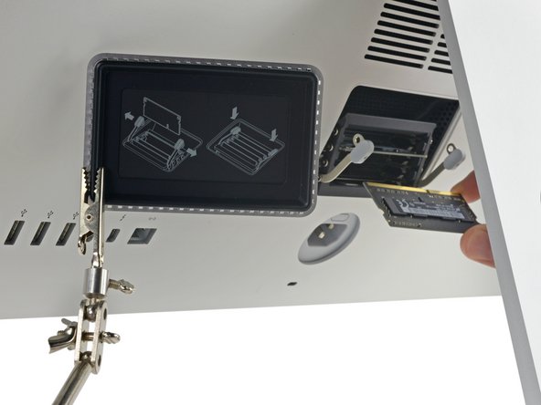

    • Fixers rejoice! The iMac Intel 27" Retina 5K Display retains the familiar, easily accessible RAM upgrade slot from iMacs of yore.
    • For those who require assistance replacing their RAM modules, Apple has attempted to provide some direction—that you get to see after you're halfway through the process.
    • For anyone who would rather be guided by glorious high-resolution images and lovingly crafted text, that's also available.

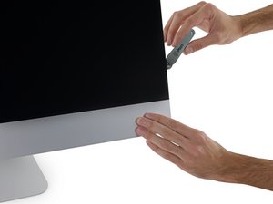

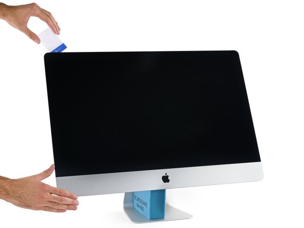

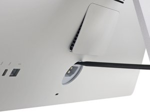

    • We're pretty adept at slicing open iMacs with our ever-so-fancy pizza cutter iMac Opening Tool and our noble Plastic Card.
    • While the procedure still requires a steady hand and a willingness to replace the custom-cut, two-sided adhesive tape when you're done, it's otherwise pretty straightforward, and unchanged from previous models.
    • With the adhesive tape gone, we get our first peek at the hardware inside the Retina 5K iMac.

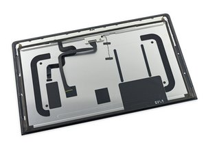

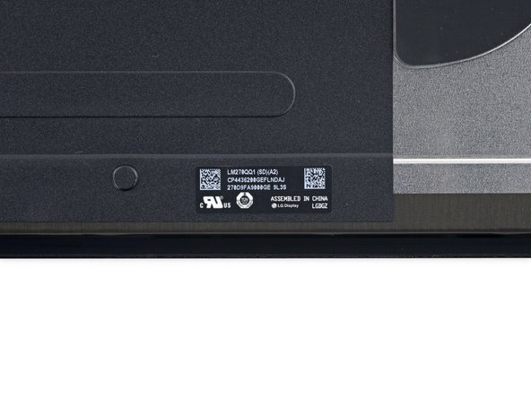

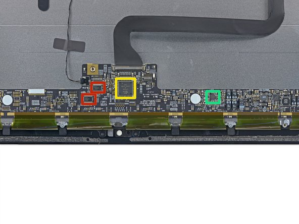

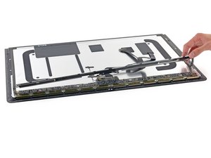

    • The first order of business is finding out whether this 5K display runs on actual magic, or something more susceptible to dissection.
    • This particular display was manufactured by LG Display. (So, magic is looking less likely.)
    • With a few twists of our screwdriver, a very long, very thin display board is revealed.

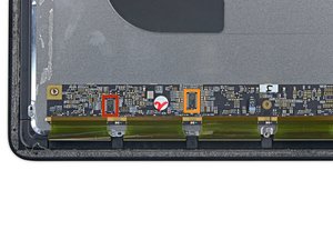

  6. iMac Intel 27" Retina 5K Display Teardown: step 6, image 1 of 3 iMac Intel 27" Retina 5K Display Teardown: step 6, image 2 of 3 iMac Intel 27" Retina 5K Display Teardown: step 6, image 3 of 3

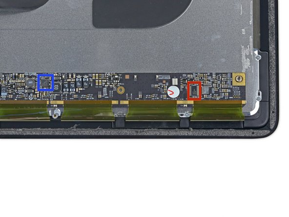

    • Let's take a look at the hardware that allows 14.7 million pixels with a resolution of 5120 x 2880 on a 27-inch display:
    • Texas Instruments NH245 8-Bit Dual-Supply Bus Transceiver
    • Texas Instruments BUF16821 Programmable Gamma-Voltage Generator and Vcom Calibrator
    • Parade Technologies DP665 LCD Timing Controller
    • We assume this is an Apple modified version of the DP663 LCD Timing Controller
    • Texas Instruments TPS65270 Monolithic Dual Synchronous Buck Regulator
    • Texas Instruments TPS65168 High Resolution Fully Programmable LCD Bias IC for TV

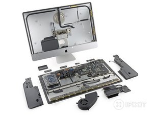

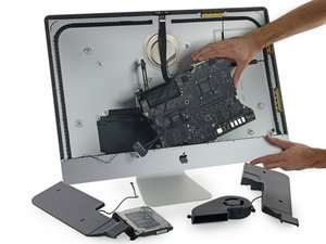

    • Barring the new display, the hardware inside the iMac Intel 27" Retina 5K Display looks much the same as last year's 27" iMac.
    • In fact, as we dive in deeper, we realize it is very nearly exactly the same.
    • We would have documented the logic board removal, but we already have! We'll be following last year's logic board guide—check it out and head back here while we skip ahead.

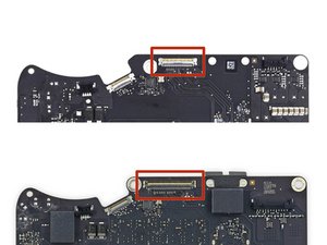

    • And after following the guide to the letter, we've got our findings on the differences inside:
    • The Retina 5K's display data cable is slightly wider—to support those extra pixels.

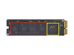

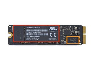

    • This looks to be the exact same SanDisk PCIe SSD as the one found in the MacBook Pro 13" Retina Display Late 2013.
    • Unsurprisingly, we find the exact same ICs:
    • SanDisk 05131 016G 16 GB NAND Flash (four on each side, total of 8 x 16 GB = 128 GB)
    • SK Hynix H5TQ2G63DFR 2 GB DDR3 SDRAM
    • Marvell 88SS91383 PCIe SSD Controller

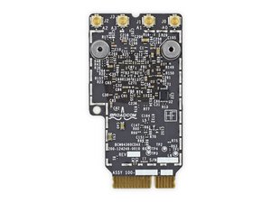

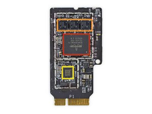

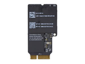

    • The AirPort/Bluetooth card, identified by its model number BCM94360CD, is exactly the same as the one we encountered in last year's iMac Intel 27 inch:
    • Broadcom BCM4360KML1G 5G WiFi 3-Stream 802.11ac Gigabit Transceiver
    • Skyworks SE5516 Dual-Band 802.11a/b/g/n/ac WLAN Front-End Module
    • Broadcom BCM20702 Single-Chip Bluetooth 4.0 HCI Solution with Bluetooth Low Energy (BLE) Support
