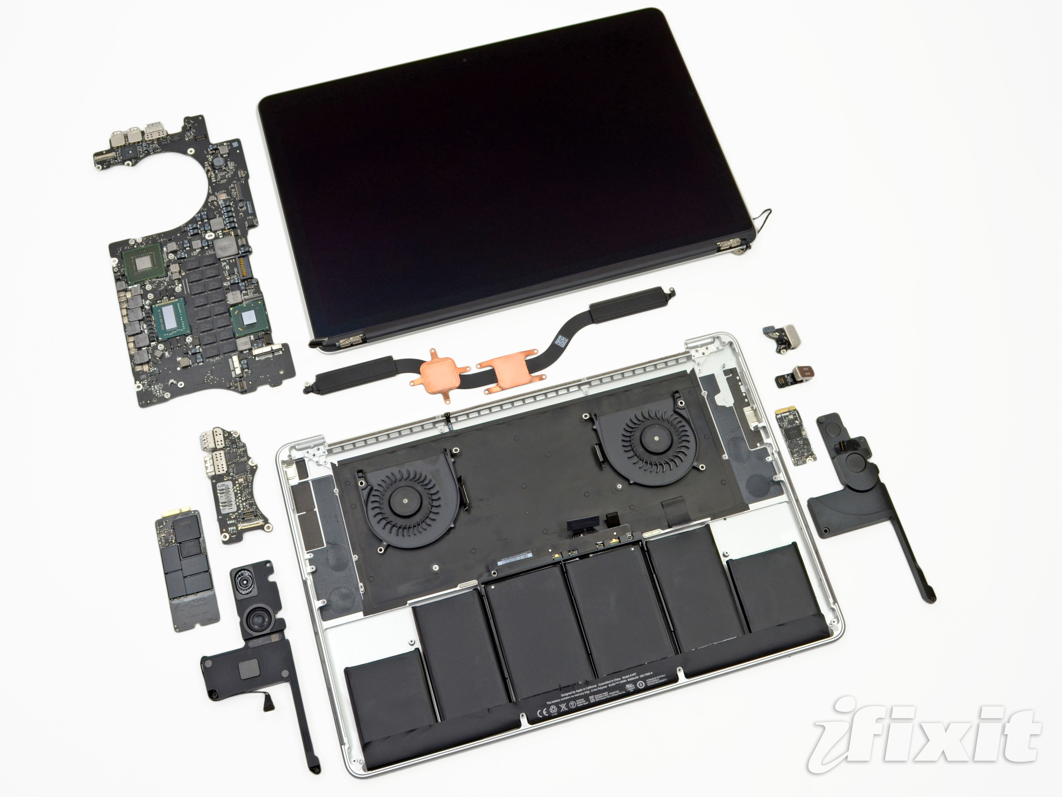

    • Now we are getting to the good stuff, starting with the SSD. We found a 512 GB Samsung flash memory module.
    • The chips are marked:
    • Samsung S4LJ204X01 3-core ARM SSD controller chip - revision seems newer than 830-series SSD
    • Samsung 213 K9UHGY8U7A 20nm MLC NAND chips
    • Samsung 201 K4T263140F 256MB DDR2-800 cache memory
    • Proprietary flash memory is nothing new to Apple. It is, however, new to the MacBook Pro lineup.

    • A bracket, some antenna cables, a few screws, and finally we get to the crème de la crème, the fan with asymmetric blade spacing.
    • We jumped at calling the fan inside the Mid-2012 MacBook Air 13" "asymmetrical," but when compared to the fan inside this MacBook Pro, the Air's fan is definitely more periodic.
    • Theoretically, the asymmetry spreads the noise produced over multiple frequencies, making it less noticeable.
    • This fan has been mentioned in almost all press on the MacBook Pro with Retina display. We are surprised at how much attention a minor blade spacing change is getting. It is nevertheless a testament to how much attention Apple puts on minor details overlooked by the rest of the industry, all for the comfort of the end user.

    • The next piece out is the processor and GPU heat sink and exhaust air vent assembly.
    • By pushing the air through a restriction before it gets to the outermost vents, you introduce an additional pressure drop (due to fluid shear stress at the walls) that accelerates the air and pushes it out of the computer faster.
    • With that last obstacle out of the way, the logic board comes out fairly effortlessly.

    • Major players on the front of the logic board include:
    • NVIDIA GeForce GT 650M GPU
    • Intel Core-i7 3720QM 2.6 GHz processor (Turbo Boost up to 3.6 GHz) with Intel Graphics HD 4000.
    • What appears to be an Intel E208B284 Platform Controller Hub
    • Hynix H5TC2G83CFR DDR3L SDRAM
    • Intel DSL3510L Thunderbolt controller
  16. MacBook Pro 15" Retina Display Mid 2012 Teardown: step 16, image 1 of 1
  17. MacBook Pro 15" Retina Display Mid 2012 Teardown: step 17, image 1 of 1
    • The back of the logic board revealed:
    • Hynix H5TC2G83CFR DDR3L SDRAM 2Gbit 1600MHz chips
    • Hynix H5GQ2H24AFR - 2.5GHz 2Gbit GDDR5 memory chips
    • Texas Instruments Stellaris LM4FS1AH microcontroller with integrated ARM core
    • Renesas R4F2113 H8S series CISC MCU
    • Maxim MAX15119 Apple-specific IMVP7 CPU/GPU power controller
    • Cypress Semiconductor CY8C24794-24L - a Programmable SoC

    • Someone really did not want the battery in the MacBook Pro to come out of the upper case.
    • We tried valiantly with our iFixit 6 Inch Metal Ruler to free the battery from its aluminum confines, but to no avail. Rather than risk puncturing a lithium-polymer battery cell, we left the power source in place.
    • To complicate matters further, the TrackPad cable lies underneath the battery. Attempting to pry the battery off the upper case could easily sever the fragile cable, which would be bad.
  22. MacBook Pro 15" Retina Display Mid 2012 Teardown: step 22, image 1 of 2 MacBook Pro 15" Retina Display Mid 2012 Teardown: step 22, image 2 of 2
    • MacBook Pro with Retina Display 15" Mid 2012 Repairability Score: 1 out of 10 (10 is easiest to repair).
    • Proprietary pentalobe screws prevent you from gaining access to anything inside.
    • As in the MacBook Air, the RAM is soldered to the logic board. Max out at 16GB now, or forever hold your peace—you can't upgrade.
    • The proprietary SSD isn't upgradeable either (yet), as it is similar but not identical to the one in the Air. It is a separate daughtercard, and we’re hopeful we can offer an upgrade in the near future.
    • The lithium-polymer battery is glued rather than screwed into the case, which increases the chances that it'll break during disassembly. The battery also covers the trackpad cable, which tremendously increases the chance that the user will shear the cable in the battery removal process.
    • The display assembly is completely fused, and there’s no glass protecting it. If anything ever fails inside the display, you will need to replace the entire extremely expensive assembly.
