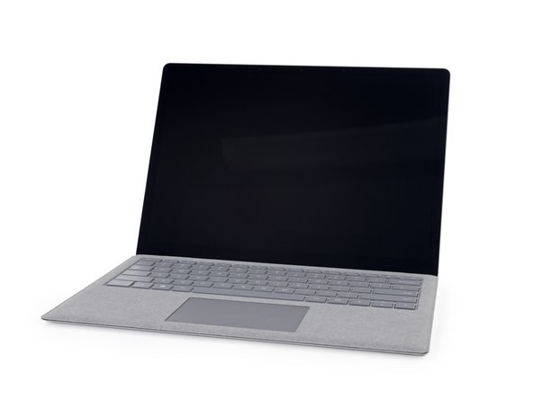

    • Alright, the Surface Book is out of the box and on our chopping block teardown table. Here's what we're looking to find today:
    • 13.5” IPS PixelSense™ Display with 2256 × 1504 resolution (201 PPI)
    • Intel Kaby Lake Core i5 (3M Cache, up to 3.10 GHz) or Core i7 (4M Cache, 4.00 GHz) CPU
    • 4 GB/8 GB/16 GB RAM
    • 128 GB/256 GB/512 GB PCIe SSD storage
    • 720p front-facing camera with Windows Hello sign-in
    • USB 3.0 port, Mini DisplayPort, and SurfaceConnect charging port
    • 802.11ac Wi-Fi wireless networking, IEEE 802.11 a/b/g/n compatible, Bluetooth Wireless 4.0 technology

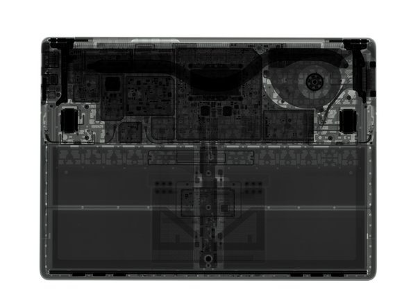

    • Before we delve into (presumably) another repair nightmare, let's get the lay of the land with some sweet X-rays.
    • Thanks, Creative Electron!
    • Looks like we're gonna see a lot of battery, a fan, and a beefy heat sink.
    • Plus, a lot of shielding. This thing already looks scary.
