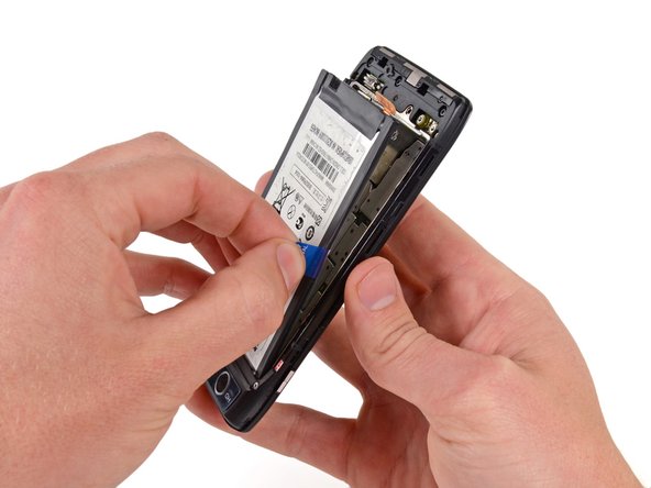

A flick of our spudger, a twist of our T5 torx screwdriver, a click of our heels, and badabing badaboom—the battery's disconnected.
It's quite the ordeal for removing the battery, but at least you don't have to rip the entire phone apart like a certain other phone we know.
Instead of the traditional battery connector socket or soldered wires found in other phones, the Droid RAZR utilizes contact points for its battery connector.

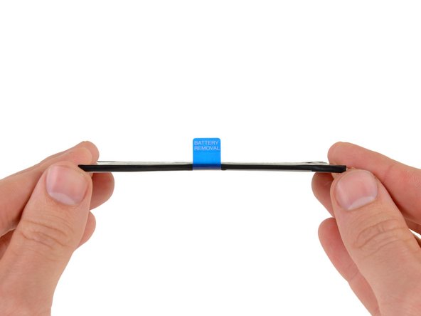

With the battery no longer firmly attached to the phone, all we have to do is pull the handy "remove battery" tab—ironic, since allegedly the battery's not supposed to be user-replaceable. Oh well.

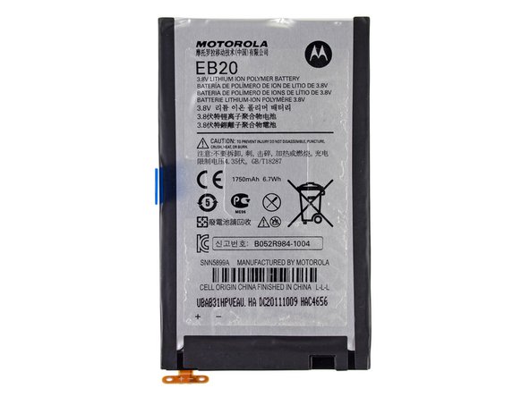

Measuring in at 3.79" long, 2.25" wide, and .110" thick with a capacity of 1750 mAh, this battery provides over 300 mAh more capacity than that of the iPhone 4S.
For those faithful repair enthusiasts who are still rocking the original 2004 Motorola RAZR V3, the Droid RAZR has a 1070 mAh greater capacity than its great-grandfather.
The battery is ultra-thin, taking up less than half of the phone's total thickness.

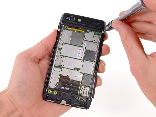

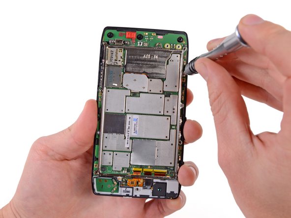

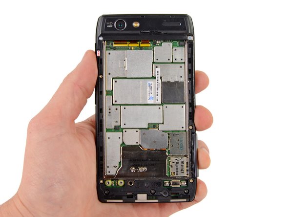

What we had once called a forest of EMI shields has now met its match. The Droid RAZR boasts an Amazon Basin's worth of EMI shields impeding our progress.
With the help of our T5 screwdriver, we twist out a few screws from the aluminum and plastic frames still covering the motherboard.

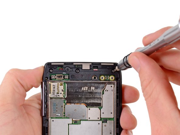

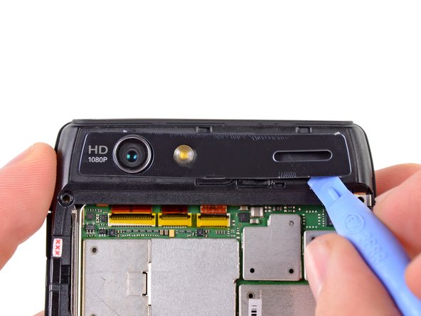

We were prepared to remove the rear inner framework when suddenly our super iFixit senses detected a hidden screw!
We peeled off the plastic cover from around the rear-facing camera to reveal a hidden screw near the flash LED. Sneaky, sneaky Motorola.

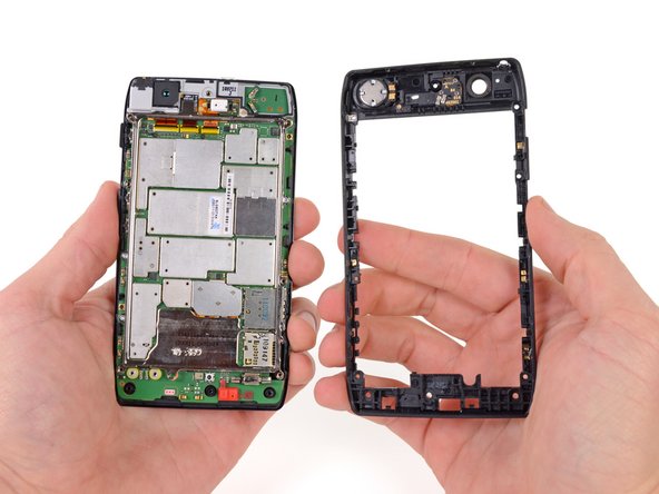

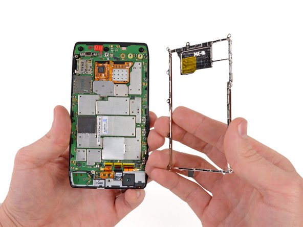

Dispatching that mischievous screw, and disconnecting several small clips around the perimeter of the rear inner framework enabled us to remove it from the motherboard and display assembly.
Tool used on this step:Coin$2.99
A few more Torx screws, and we're able to remove the diamond-cut aluminum chassis.
Why diamond-cut? Motorola needed ultimate precision when manufacturing this thin and light weight component.

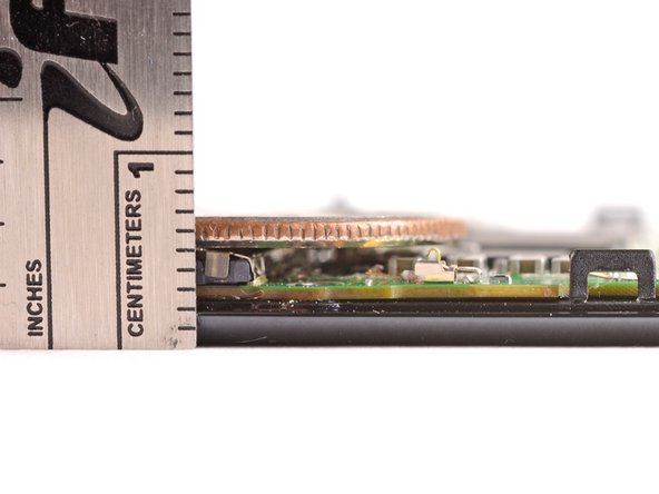

How extreme are the space constraints inside a device this thin?
From the bottom to top, you can see the glass, display, motherboard, motherboard chips, and then quarter. (Quarter sold separately)

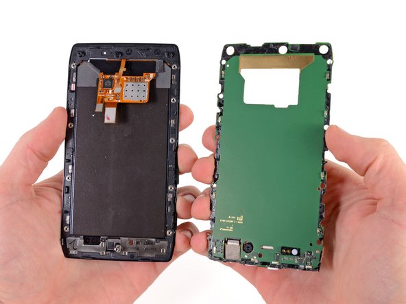

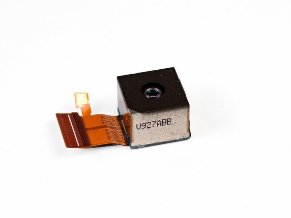

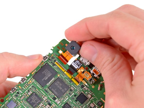

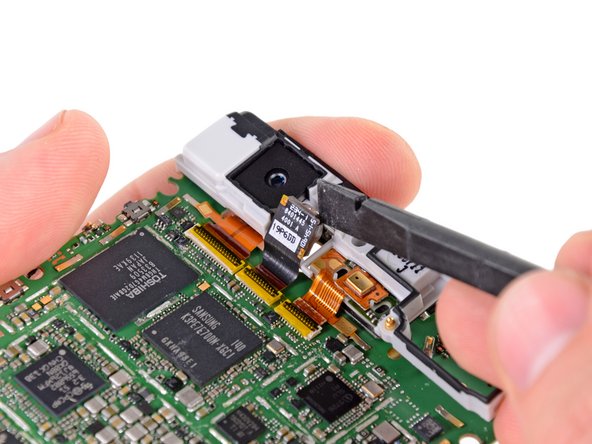

Pulling back the 1.3 MP front-facing camera, apparently capable of 720p HD video, we are now able to undo all the connectors.
Zif-a-dee-doo-dah! Zif-a-dee-day! Yes, those are all ZIF type connectors, and yes, they all must bite the dust.
Ah, so that's the reason the RAZR is a bit
fatheadedtop-heavy. The larger rear-facing camera boasts 8 MP still picture capability and 1080p video at 30 fps. -
Trying to take video in a fast moving or high vibration environment? Sacrifice a little resolution, down to 720 x 480, and pick up your frame rate to a blistering 120 fps to keep the blur down.
The rear-facing camera is marked as V927ABB.

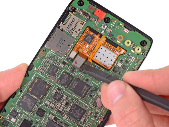

Holy cannoli! Look at all 'em chips! To keep the design svelte, Motorola packed pretty much everything on one side of the mobo. Let's see what we're dealing with:
Toshiba THGBM4G7D2GBAIE 16GB EMMC Flash Memory
Samsung K3PE7E700M-XGC1 4Gb LPDDR2 RAM
Qualcomm MDM6600 Dual-Mode Baseband/RF Transceiver
Qualcomm PM8028 Power Management IC
Avago ACPM-7868 Quad-Band Power Amplifier
Motorola T6VP0XBG-0001 (believed to be the LCM 2.0 LTE baseband processor)
Texas Instruments WL1285C Wilink 7 Bluetooth/Wi-Fi/GPS
So many chips…where's the dip?:
Skyworks 77449 Power Amplifier Module for LTE/EUTRAN Bands XIII/XIV
Toshiba Y9A0A111308LA Memory Stack
ST Ericsson CPCAP 6556002
Hynix H90H1GH51JMP (similar to other devices we've seen, this POP chip sits on top of the TI OMAP 4430 processor)
Infineon 5726 SLU A1 H1118 3A126586
Bosch 2133 C3H L1ABG accelerometer
And the back of the board? Even the PCB is stepped with a cavity to recess the flex wrap from back to front. Nothing spared in the pursuit of ultimate thinness.
