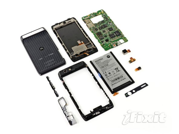

The Droid RAZR is here, calling upon state-of-the-art space-saving technology, as well as a bit of nostalgia. Claiming once again to have made the thinnest phone in the universe, the Droid RAZR touts impressive features packed into one package. For safety reasons, we will not be throwing it around to see if it will cut bikes and lamp posts (as its trailer suggests), or shooting it to verify if it's bulletproof (we know it's not) -- but we will be opening it up to see what gives it its phone, video, audio and gaming powers.

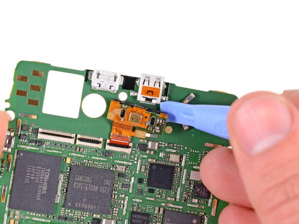

    • The micro-USB and micro-HDMI ports are located at the top of the phone, next to the 3.5 mm headphone jack.
    • Motorola likely chose this spot because the rest of the phone's slim profile would not be able to fit the ports.

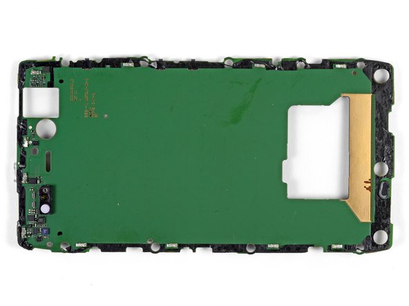

    • How extreme are the space constraints inside a device this thin?
    • From the bottom to top, you can see the glass, display, motherboard, motherboard chips, and then quarter. (Quarter sold separately)
    • Check out how the motherboard compares to a quarter. The motherboard with ICs is thinner than 3 quarters stacked together.

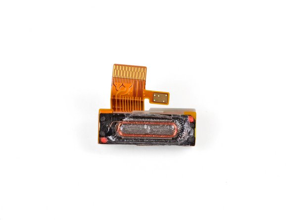

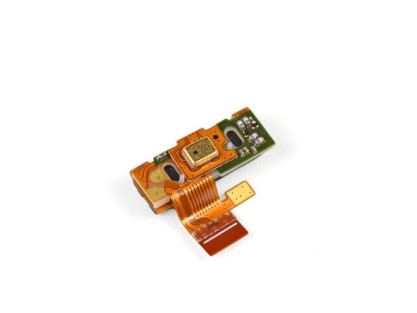

    • What's that? I can't hear you—speak up. Oh, you're the ear piece, I see. Well, I'm sorry, you're going to have to come out too.
    • No leopard print on this ribbon cable, but that's ok. It's just the main speaker.
    • For those itching to reveal their love of Britney Spears new album or Justin Beiber's new hit solo, fret not, this tiny litte speaker packs enough power to resonate [tinny, muddled] music throughout the room.

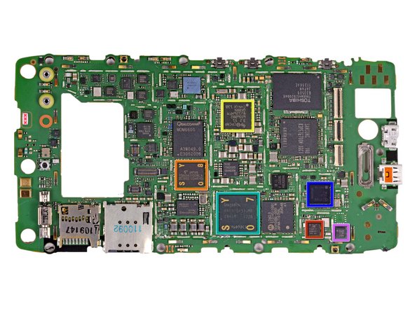

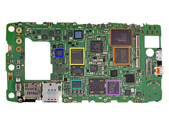

    • Holy cannoli! Look at all 'em chips! To keep the design svelte, Motorola packed pretty much everything on one side of the mobo. Let's see what we're dealing with:
    • Toshiba THGBM4G7D2GBAIE 16GB EMMC Flash Memory
    • Samsung K3PE7E700M-XGC1 4Gb LPDDR2 RAM
    • Qualcomm MDM6600 Dual-Mode Baseband/RF Transceiver
    • Qualcomm PM8028 Power Management IC
    • Avago ACPM-7868 Quad-Band Power Amplifier
    • Motorola T6VP0XBG-0001 (believed to be the LCM 2.0 LTE baseband processor)
    • Texas Instruments WL1285C Wilink 7 Bluetooth/Wi-Fi/GPS
  19. Motorola Droid RAZR Teardown: step 19, image 1 of 2 Motorola Droid RAZR Teardown: step 19, image 2 of 2
    • So many chips…where's the dip?:
    • Skyworks 77449 Power Amplifier Module for LTE/EUTRAN Bands XIII/XIV
    • Toshiba Y9A0A111308LA Memory Stack
    • ST Ericsson CPCAP 6556002
    • Hynix H90H1GH51JMP (similar to other devices we've seen, this POP chip sits on top of the TI OMAP 4430 processor)
    • Infineon 5726 SLU A1 H1118 3A126586
    • Bosch 2133 C3H L1ABG accelerometer
    • And the back of the board? Even the PCB is stepped with a cavity to recess the flex wrap from back to front. Nothing spared in the pursuit of ultimate thinness.

"1 GB RAM"
"Samsung K3PE7E700M-XGC1 4Gb LPDDR2 RAM"
So does it have 1 or 4 Gb of RAM?
ctcsme - Reply
4Gb (4 gigabits) = 0.5 GigaBytes. I don't know where the other 0.5 GB is.
cityzen -
another 512MB is on the omap4
Lai Zhijie -
where's its CPU,omap4466
tom - Reply
yeah, where's CPU!?
