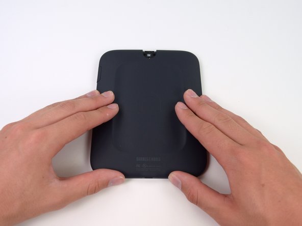

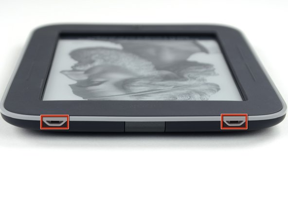

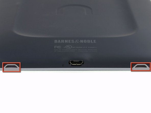

  2. Nook Simple Touch with GlowLight Teardown: step 2, image 1 of 3 Nook Simple Touch with GlowLight Teardown: step 2, image 2 of 3 Nook Simple Touch with GlowLight Teardown: step 2, image 3 of 3
    • Move along; nothing to see here.
    • The back and sides of the device contain no surprises.
    • The power button is large, but must be pressed in a certain spot to actually click. It also seems rather loosely attached.
    • Four indents (two on top, two on bottom) in the front case of the GlowLight look like they may help out with disassembly. Possible points for repairability?

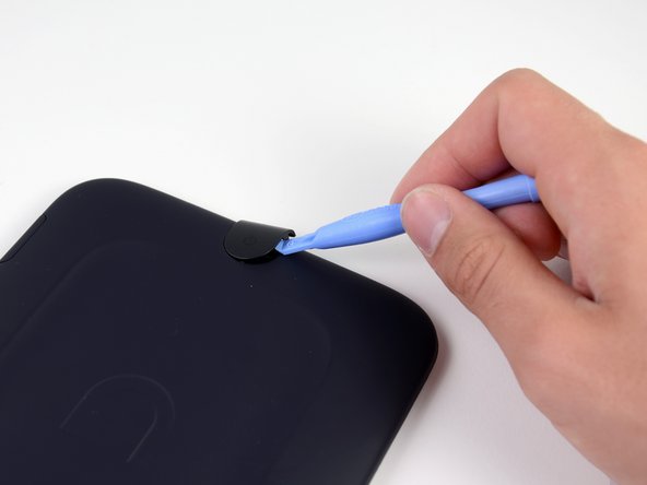

  4. Nook Simple Touch with GlowLight Teardown: step 4, image 1 of 3 Nook Simple Touch with GlowLight Teardown: step 4, image 2 of 3 Nook Simple Touch with GlowLight Teardown: step 4, image 3 of 3
    Tool used on this step:
    Metal Spudger Set
    $7.99
    Buy

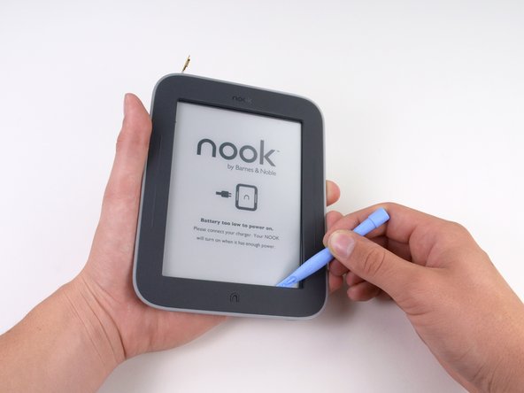

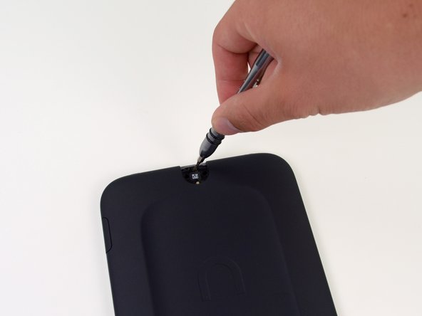

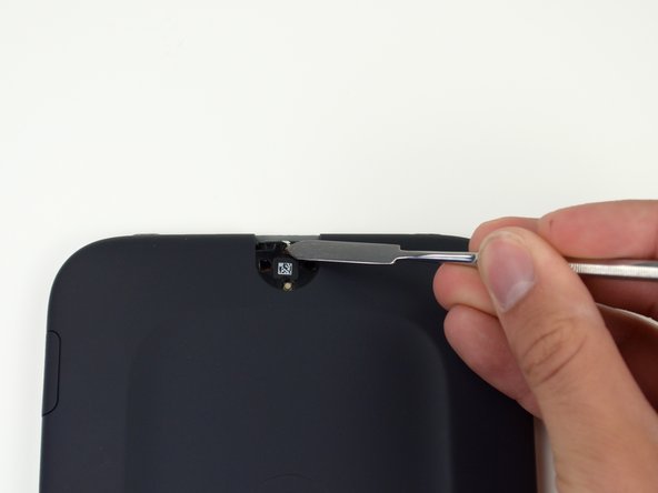

    • The instability of the power button proves helpful as we easily pop it off with a plastic opening tool.
    • The clips on the outside and the ease of prying off the button gave us a warm, fuzzy, repair-friendly feeling. That tamper-proof sticker, however, did not.
    • Below the sticker we see the power button sensor. Its small size and lower location explain the difficulty of pressing the button.
    • Oh well…so long warranty! Our metal spudger takes care of that.

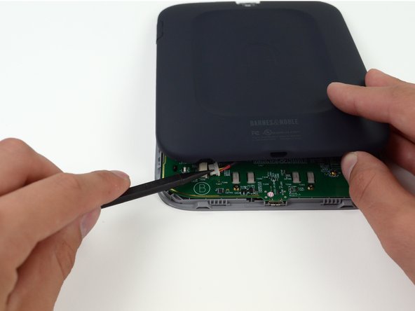

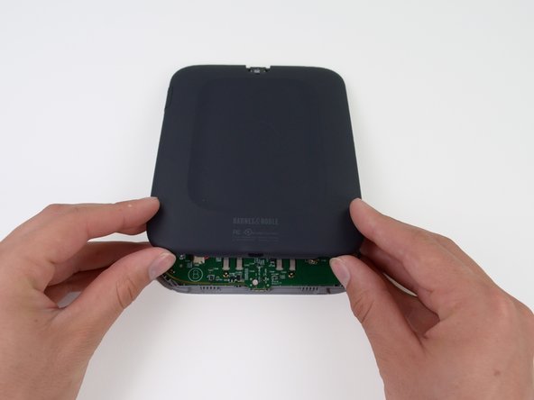

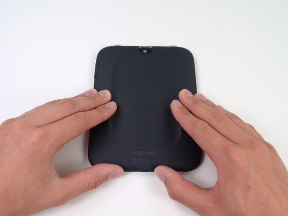

  5. Nook Simple Touch with GlowLight Teardown: step 5, image 1 of 3 Nook Simple Touch with GlowLight Teardown: step 5, image 2 of 3 Nook Simple Touch with GlowLight Teardown: step 5, image 3 of 3
    • It appears that only a single T5 Torx screw, which is easily removed with our 54 Bit Driver Kit, stands between us and the glowing innards of the newest Nook.
    • With the screw out of our way all we have to do is slide the rear panel down to free it.
    • Tamper-proof sticker aside, this device is starting to receive some glowing repairability reviews around the office.

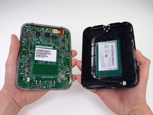

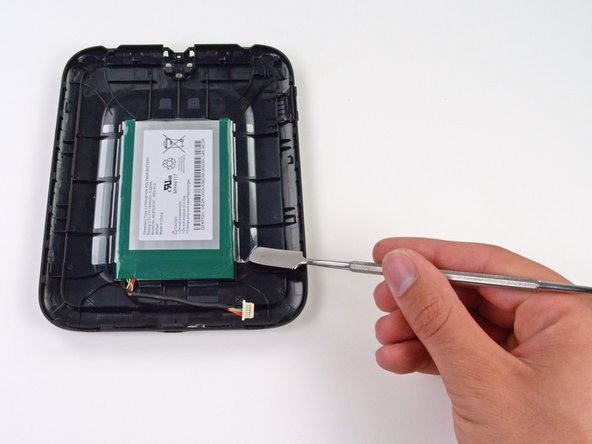

    • As our spudger comes out to disconnect the solitary battery connector, we wait for something along the lines of this to happen.
    • Unfortunately, this is all we get. No glowing aura; no chest full of gold; not even a speck of pixie dust. The only explanation is that the GlowLight must have some other form of mythical power behind it.

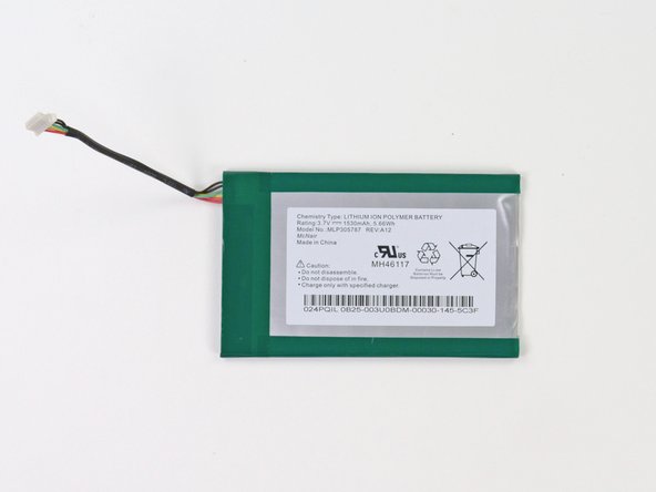

  7. Nook Simple Touch with GlowLight Teardown: step 7, image 1 of 3 Nook Simple Touch with GlowLight Teardown: step 7, image 2 of 3 Nook Simple Touch with GlowLight Teardown: step 7, image 3 of 3
    Metal Spudger
    $2.99
    Buy

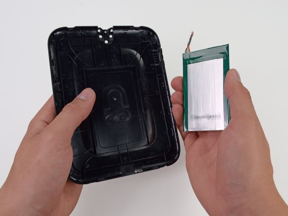

    • The only two components attached to the rear panel are the microSD flap and the battery.
    • The battery is held in place by some heavy duty tape, but our metal spudger eventually unsticks it all.
    • The battery is rated at 3.7V and 1530 mAh for 5.66 Wh—a solid rating for an e-reader.
    • Barnes & Noble claims that the battery provides, at an average of one hour of reading per night, one month of usage per charge with the GlowLight on, or two with it off.

    • In most teardowns, this is about the step when we start disconnecting a billion things from the motherboard. This, however, is not most teardowns.
    • A mere eleven T5 Torx screws, one ZIF connector, and the display cable connector hold the motherboard in place.

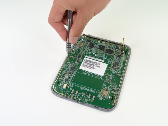

  9. Nook Simple Touch with GlowLight Teardown: step 9, image 1 of 3 Nook Simple Touch with GlowLight Teardown: step 9, image 2 of 3 Nook Simple Touch with GlowLight Teardown: step 9, image 3 of 3
    Heat Gun
    $24.99
    Buy

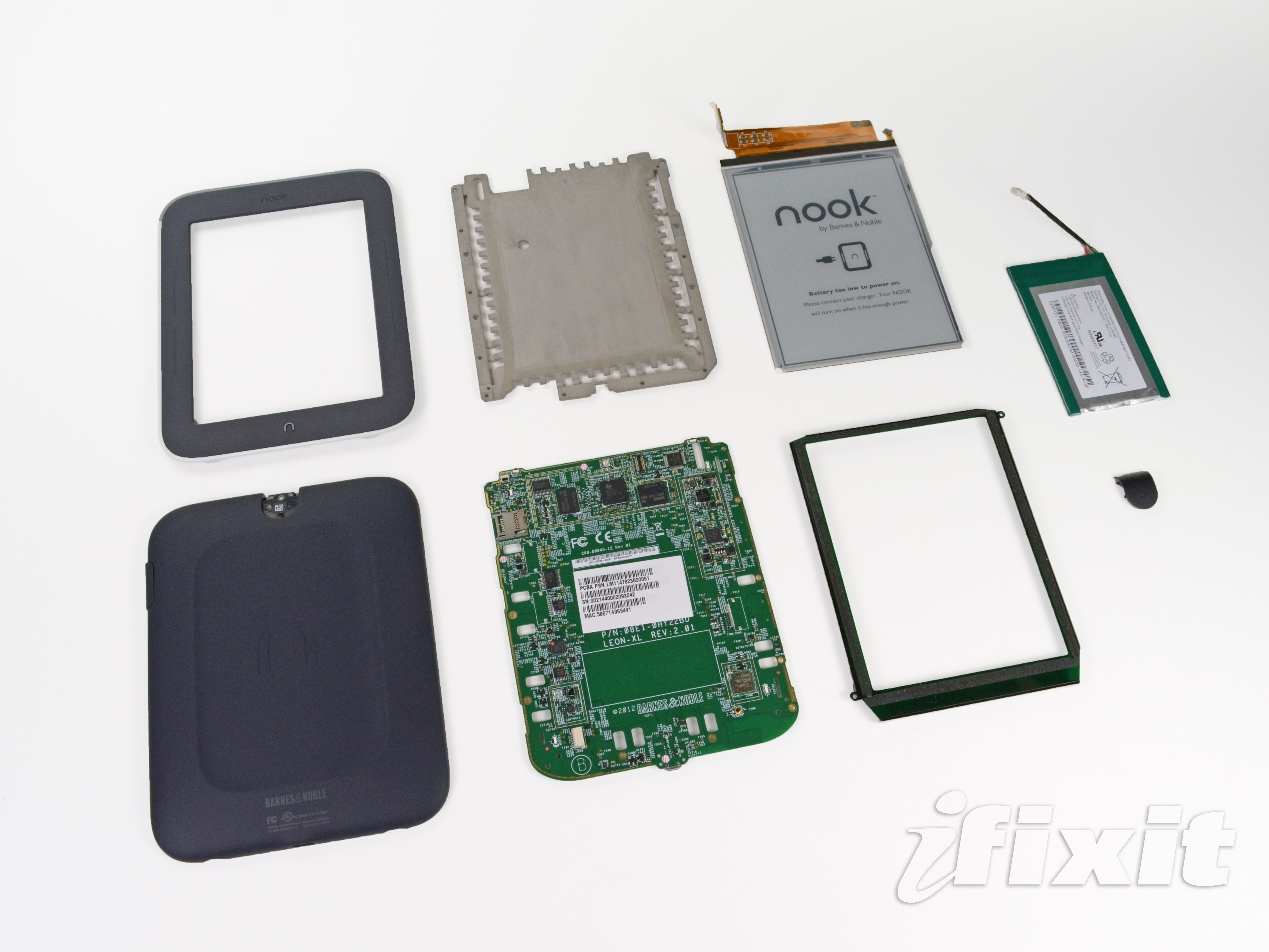

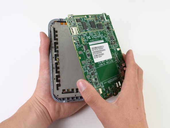

    • We remove the motherboard and are amazed as a bright aura of GlowLight magic emits from the innards of the device (aura not pictured).
    • Though the device has proven very simple to take apart, we do note that all of the components are held on with a lot of adhesive. We have not had to use a heat gun yet, but we tread carefully as we remove the heavily adhered motherboard from the frame.
    • While devices often implore us not to dig into them, the Nook Simple Touch with GlowLight keeps on smiling, even with its battery and motherboard removed, thanks to its E Ink technology.

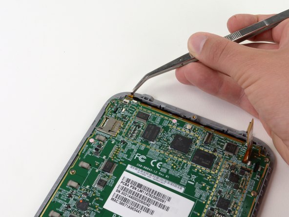

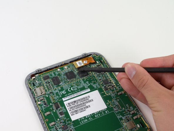

  10. Nook Simple Touch with GlowLight Teardown: step 10, image 1 of 1
    • The prominent chips on the front side of the motherboard include:
    • Texas Instruments HP4067 High Speed CMOS 16 Channel Analog Multiplexer/Demultiplexer
    • Samsung K4X2G323PC mobile 2Gb (or 256 MB) DRAM
    • Texas Instruments OMAP 3621 BCYN 800 MHz TI processor
    • Samsung KLM2G1HE3F NAND flash memory.
    • Texas Instruments TPS65921B Power Management Circuit for USB and ADC.
    • E-INK TPS65181
    • Jorjin WG7310-2A Wi-Fi module

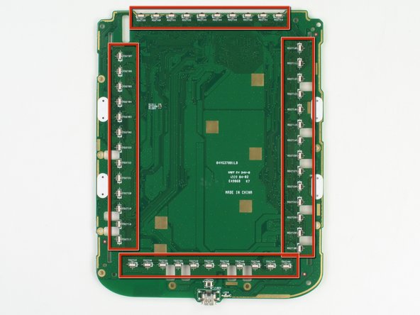

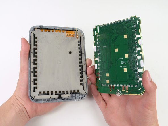

    • On the back of the motherboard we found:
    • Empty space...hmmm...
    • Closer inspection reveals rows of emitters and receivers that make up the infrared grid touchscreen.

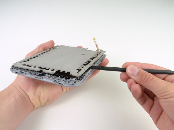

    • Time to remove the frame from the display assembly. Any guesses as to how it is secured?
    • If you guessed boatloads of adhesive, you were correct!
    • With the help of a spudger, we carefully pry the frame from the display assembly, nervously holding our breath at every creeeeek emitted from the loosening frame.
    • The frame is made out of magnesium, as opposed to the aluminum plate found in the non-lit Simple Touch. We verified this magnesium claim the hard way, apparently not having learned our lesson from last time.
    • After removing the frame, we are finally ready to take out the display assembly. We start by, surprisingly, removing more adhesive holding the display cable in place.

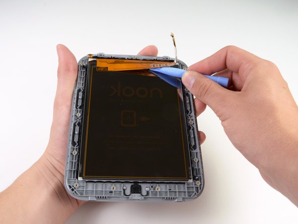

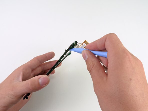

  14. Nook Simple Touch with GlowLight Teardown: step 14, image 1 of 2 Nook Simple Touch with GlowLight Teardown: step 14, image 2 of 2
    • We pry the plastic display bezel from the display assembly with our plastic opening tool .
    • The bezel is secured by a layer of tape (surprising right?) and seems to be composed out of a green translucent plastic.
    • And guess what - we found something interesting inside this device! No, seriously! We'll analyze it…WITH SCIENCE!

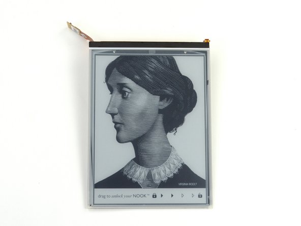

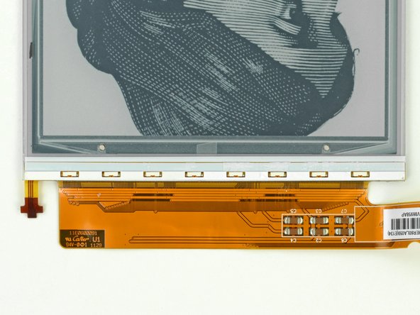

  16. Nook Simple Touch with GlowLight Teardown: step 16, image 1 of 2 Nook Simple Touch with GlowLight Teardown: step 16, image 2 of 2
    • The display assembly contains the front glass and array of GlowLight LEDs, all fused together into one component.
    • Notice the array of eight LEDs located on top of the display assembly. These LEDs are the only light for the entire screen.
    • The glass over the E-ink screen takes the light from the eight LEDs and evenly distributes it across the screen.
