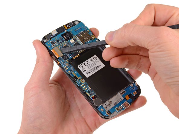

    • Insert finger here, wiggle finger thusly, and pop goes the panel!
    • OK, we'll come clean; the phone shipped with the battery removed. We first had to install the battery and back cover, and then we did some prying. This assuredly confirms one thing: the battery is user-serviceable.

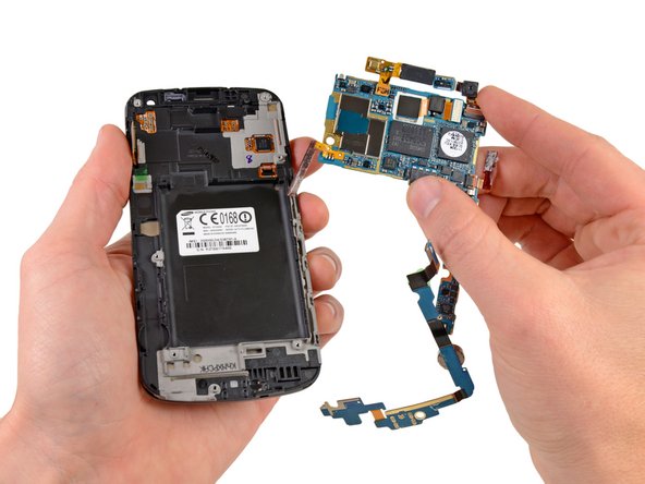

    • A few connectors here, some screws there, and a wee bit of glue everywhere…nothing stands a chance against our spudger! The motherboard dislodges from its home with moderate force, but nothing too extreme.

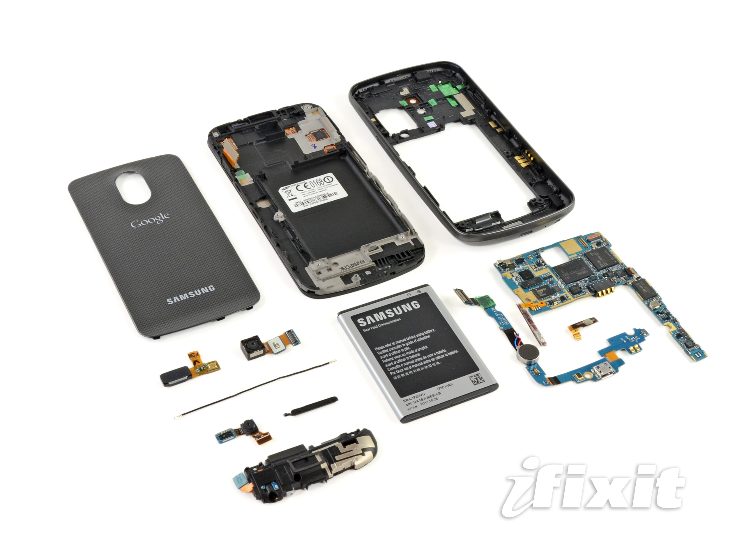

    • The primary internals of the Galaxy Nexus are held on two L-shaped boards. The small board on the left holds the vibrator motor and several connections. The large board on the right is the motherboard, which houses the volume buttons, SIM slot and the following chips:
    • Texas Instruments TWL6040 8-Channel High Quality Low-Power Audio Codec
    • Texas Instruments TWL6030 Fully Integrated Power Management with Switch Mode Charger
    • Invensense MPU-3050 Motion Processing Unit
    • Intel XG626 Baseband Modem
    • Bosch BMP180 MEMS Pressure Sensor
  12. Samsung Galaxy Nexus Teardown: step 12, image 1 of 1
    • Flipping both boards over reveals a lot of nothing on the smaller board, but a ton of chips on the motherboard—a "smörgÃ¥s-board," if you will:
    • RFMD RF6260 Quad-band Multimode Power Amplifier Module
    • Samsung KMVYL000LM Multichip Memory Package, which we believe to house 512 MB of RAM in addition to the main processor.
    • Samsung K3PE7E700M 512 MB DDR2 SDRAM
    • Samsung SWB-B42 BT 4.0 Dual Band Wlan FM Tx/Rx. Chipworks says the module is actually manufactured by Murata, and houses a Broadcom BCM4330 die inside.
    • NXP 65N00 Smart Card IC. According to Chipworks, this two-die package houses an MCU and a PN544 NFC controller.
    • Silicon Image 9244 MHL transmitter
    • SiRF SiRFstarIV GSD4t GPS tracker
