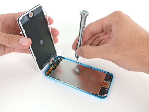

  7. iPod Touch 5th Generation Teardown: step 7, image 1 of 2 iPod Touch 5th Generation Teardown: step 7, image 2 of 2
    • Do not adjust your screens, the images you see here have a purpose.
    • In case you thought that a quick zap with the heat gun and a gentle pry is all it would take to get into the Touch, think again!
    • There are clips (first image) and adhesive (second image, near the home button) holding this iPod together.

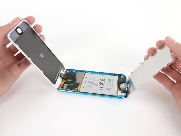

  8. iPod Touch 5th Generation Teardown: step 8, image 1 of 2 iPod Touch 5th Generation Teardown: step 8, image 2 of 2
    • Sadly, getting the lid off doesn't reveal any of the more "funner" we were promised. We were expecting to find a surprise—maybe a clue that would lead to the whereabouts of Jimmy Hoffa's remains—but instead we were met with an obtrusive EMI shield and several screws.
  9. iPod Touch 5th Generation Teardown: step 9, image 1 of 1
    • With the EMI shield out of the way, we get our first look at the battery.
    • The iPod Touch 5th Generation is optimized to provide up to 40 hours of music when fully charged.
    • That is enough to get you through a standard work week.

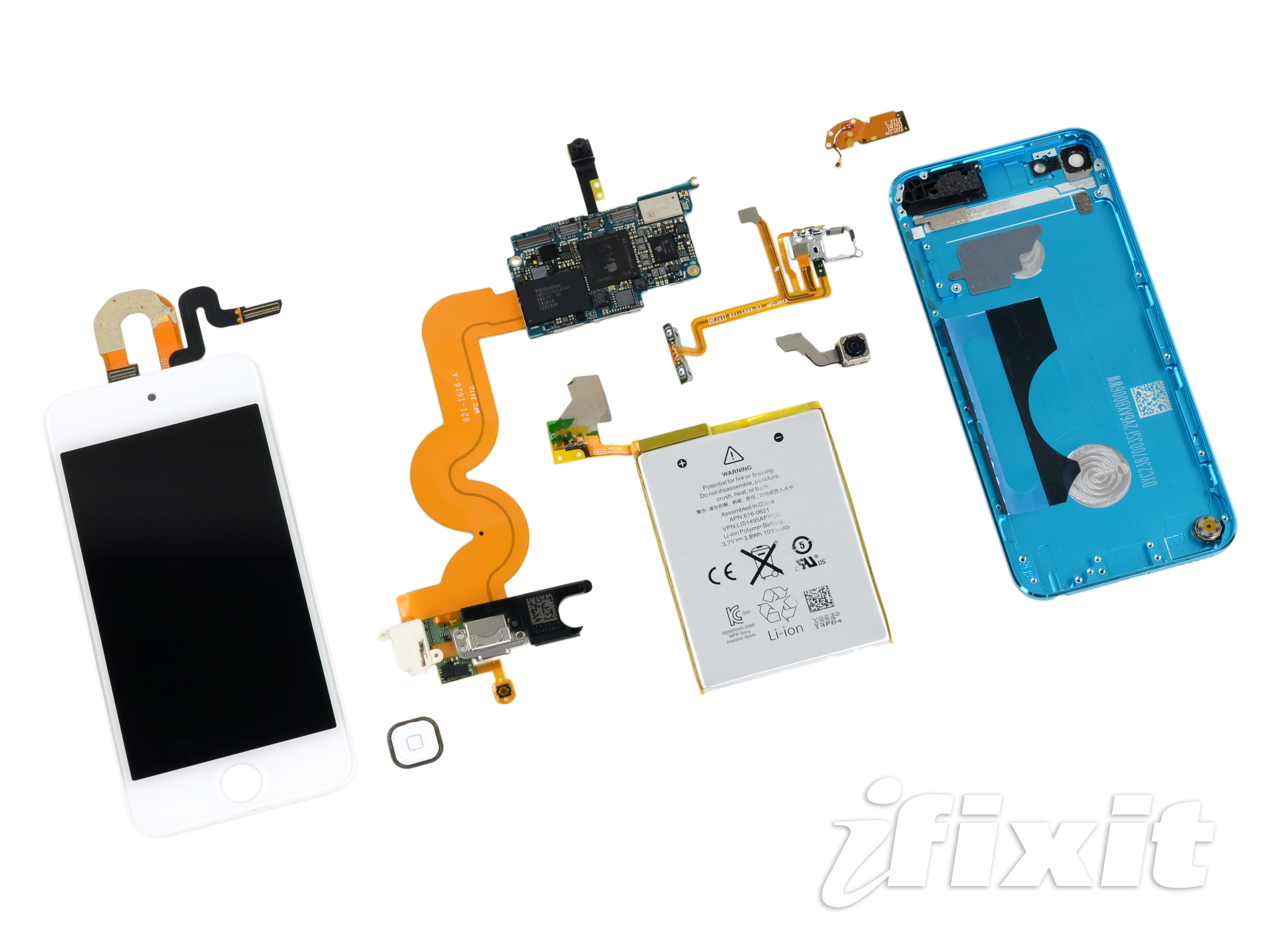

  22. iPod Touch 5th Generation Teardown: step 22, image 1 of 2 iPod Touch 5th Generation Teardown: step 22, image 2 of 2
    • iPod Touch 5th Generation Repairability: 3 out of 10 (10 is easiest to repair).
    • While very difficult, opening the case and replacing components is not impossible.
    • The battery is flanked by notches that make prying it out of the rear case fairly easy.
    • Many components are soldered together, requiring either a very difficult or very expensive repair if any one part breaks.
    • The Touch has no external screws. Instead, a combo of clips and adhesive makes it difficult to open the case.
    • Cables connected to the logic board run over the top and connect on the bottom, making it difficult to remove the board or disconnect the cables.
