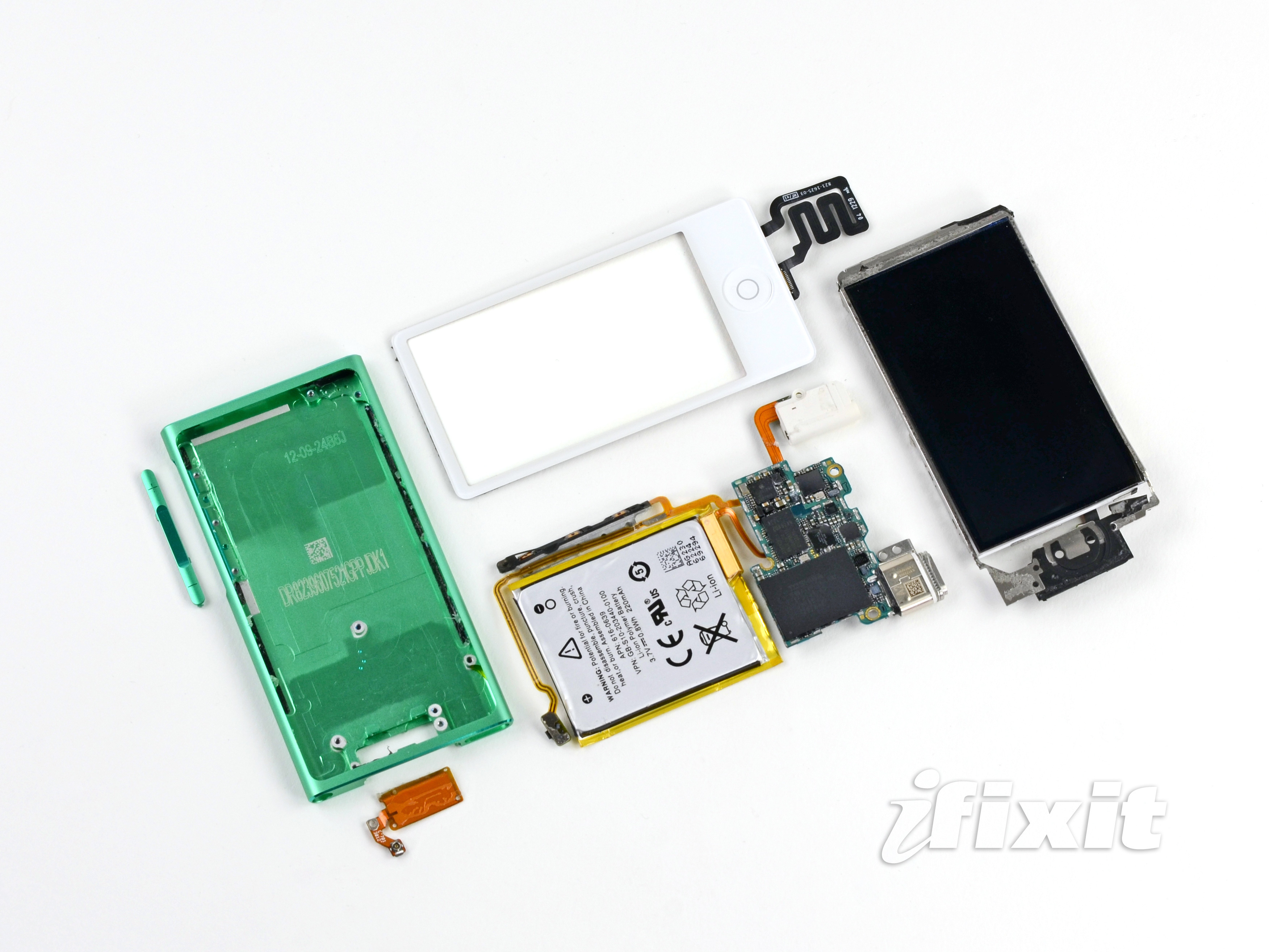

    • We've got a full house in our hand with the bezel, logic board and battery assembly, and the rear case.
    • We hope that the minds at Apple aren't as twisted as their cables. Cables with this much form probably come out of engineering efforts to make this iPod as thin as possible.

    • After enough poking and prying to earn ourselves certification as plastic surgeons, we finally gently yank out the logic board!
    • As in the iPod Touch 5th Generation, many of the important components—including the battery, Lightning connector, and volume controls—are soldered to the logic board.
    • With the logic board gone, the rear case is left all alone with no friends to keep it company. It's not easy being green, you know.

    • iPod Nano 7th Generation Repairability: 5 out of 10 (10 is easiest to repair).
    • An easy-to-open case only requires unscrewing two screws and a plastic opening tool.
    • Only standard Phillips #00 screws are used—no security or pentalobe.
    • The LCD and digitizer glass are not fused together, allowing replacement of either component separately.
    • "External" screws hidden behind the antenna mean less adhesive holding down the display assembly.
    • The battery, Lightning connector, button cable, and headphone jack are all soldered to the logic board.
    • The battery is adhered to the back of the display assembly.
