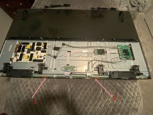

Guys,
my TV has been acting up and it is now stuck. Everytiem i turn it off and on again.. it turns itself OFF after a few minutes. I noticed that when i turn it ON the power light flashes a few times.
Anyone face this issue before and if so hwo did you fix it?

@aliyousef8787 sounds like your TV is turning off because it does it's POST (Power On Self Test) and finds something not working. Time to remove the back cover and check the boards. Start by measuring the voltages rom your power board to the rest of the TV. We would need to see your boards, interconnect cables and total inside of your TV. Adding images to an existing question
Schematics and help from the manufacturer's is not available. they do not want you to fix the TV but want you to buy a new one. So, you have to depend on yourself. Large panel TV's like this are still having trouble with power supplies etc. so I would definitely start with that.

Update (06/20/23)
@aliyousef8787 let's try this. Disconnect the ribbon cable from the frist driver board. then try to start your TV. Has the Behaviour changed? What does your TV show? Turn your TV off, disconnect power and reconnect that ribbon cable. Next disconnect the other ribbon cable and reapply power, turn your TV on. Has the Behaviour changed? What does your TV show?
What this does, is that it rules out the driver boards. If the behavior remains the same and your TV does exactly what it did before, we can be pretty confident that it is not the panel. Sometimes it is easier to determine what doesn't work,by finding out what does work.

@oldturkey03 so i got a quote for about $700 yikesssss... so i guess im going to do it myself. I am going to start by replacing the power board since its the cheapest board on there and it seems like i am having some power issues.
by
@aliyousef8787 Remove the back from your TV and post some pictures. You can do a couple of tests that make it easier to determine which board. If you got a multimeter, it'll be straight forward. My suspected sequence for a Samsung this size is usually, Main board==>Power board==>Panel
That is the order in which I check :-)
Holler if you need help.
