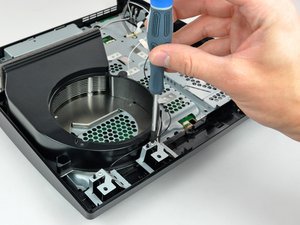

More connectors and screws to unplug/unscrew.
The design aesthetic of this machine is quite a bit more bare-bones-functional than Apple's, but is still beautiful in its own way.
Several components, including the AC power inlet, are simply held to the unit by the pressure of the screws connecting the top and bottom cases.
