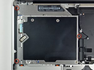

Remove the three 2.5 mm Phillips screws securing the optical drive to the upper case.
Lift the optical drive from its right edge and pull it out of the computer.
