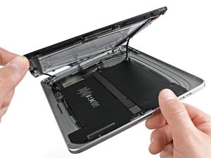

Lift the display assembly away from the rear panel assembly by its bottom edge.
Do not excessively lift the display assembly off the rest of the iPad, as a fragile antenna cable with very little slack still connects the two components.
