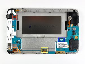

Removing the motherboard requires disconnecting several connectors:
Headphone jack/microphone cable
Volume control cable
Touchscreen cable
Control button LED cable
Display data cable
The motherboard is secured the rear panel by seven Phillips screws.
Removing the motherboard requires lifting it away from the rear panel.
