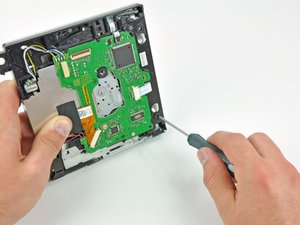

Set the DVD drive on its side, with the two rubber grommets along the front of the drive facing you.
Insert the end of the skinny screwdriver into the hole in the center of the lower rubber grommet along the front of the DVD drive housing.
Pull the screwdriver straight up until the grommet is free.
