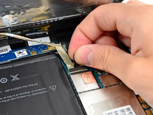

Use the attached black tab to pull the display data cable straight up and out of its socket on the motherboard.
Pull the cable upwards and not parallel to the face of the motherboard. Doing otherwise may damage the socket on the motherboard.
Take care not to pull on the ribbon that is stuck by adhesive to the bottom of cable you are detaching. It does not need to be disconnected.
