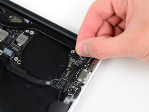

Pull the camera cable parallel to the face of the I/O board toward the rear edge of the Air to disconnect it from its socket.
Do not lift upward on this cable as you disconnect it, as its socket may break off the logic board.
