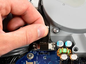

Pull the display data cable up off the logic board by its black pull tab.
De-route the display cable from the two aluminum fingers in the mid-plane.
