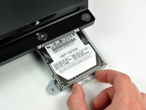

The drive enclosure has a metal pull tab attached to it. Pull on it to release the drive from the bay.
The 120 GB Toshiba drive, in all its glory. We have a feeling that it's going to be super-easy to upgrade this drive to 500GB...
