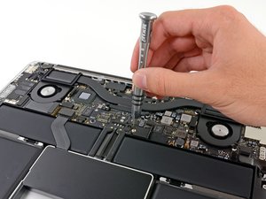

As always, we start by disconnecting the battery, a simple task that requires no more than releasing a conn—wait, what is this?
Instead of the good ol' run-of-the-mill battery connector that we've seen in most other Apple laptops, the battery is connected using several screws that hold a connector board in place.
This little PCB serves only as a bridge between the battery control board and the logic board.
…weird?
