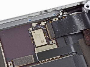

Our first exposed IC is one we've seen before, in the iPhone 5.
In fact, you might say we've got a pretty close relationship with the Murata 339S0171 Wi-Fi module.
More tricks, fewer treats! With plastic opening tool in hand, we disconnect the display connector, but there's still something holding the LCD in…
