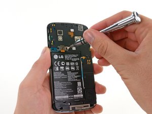

Screws hold the battery connector in place.
We make it look easy, but the battery is secured to the case with quite a bit of adhesive, requiring a lot of prying.
