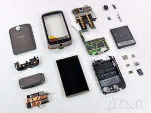

After some trying moments with a few tools of destruction, we figured out the bottom cover can simply be popped off with a plastic opening tool.
Guess what? We found more screws.
This phone uses many foil antennas attached to the several plastic internal frame pieces.
