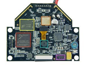

Front of motherboard:
Parrot 6 ARM9 468 MHz processor.
ROCm Atheros AR6102G-BM2D b/g Wi-Fi module.
Micron OGA17 D9HSJ
Vertical camera.
USB/serial port connector
On the back:
Micron 29F1G08AAC
