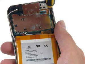

Removing three Phillips #00 screws securing the logic board to the front panel. The screws are:
Where the screwdriver is.
Underneath the black camera in the upper right hand corner.
To the left of the battery wires that are soldered to the logic board.
