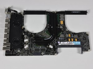

Top of logic board.
The speakers are mounted on the left next to the ports.
The heat sink covers the two NVidia chipsets and the processor.
This machine has 512 MB video memory for the NVidia 9600M. The 9400M chipset shares 256 MB of system memory. You have to log out to switch between graphics chipsets.
