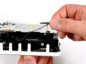

Rotate the mini 180 degrees.
Use a spudger to peel back the black tape and release the antenna cable.
Carefully lift the remaining two antennas from the right side of the mini.
