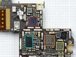

More fun chips on the logic board include:
TI 343S0538 touchscreen controller
STMicro AGD8 2135 LUSDI gyroscope
STMicro 8134 33DH 00D35 three-axis accelerometer
Apple 338S0987 B0FL1129 SGP, believed by Chipworks to be a Cirrus Logic audio codec chip
