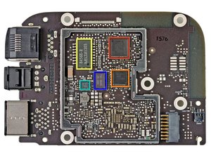

The back side of the logic board:
DELTA 8456E-R magnetic LAN coupler
TI 54418 (2.95 to 6V, 4A, 2MHz step down current mode regulator)
TXC Mn40 25.000 (25MHz crystal)
