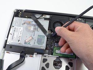

Round two with the spudger frees the AirPort/Bluetooth board and unearths the optical drive.
Hot chips on the wireless card:
Broadcom BCM4331KML1G 802.11n wireless solution
Broadcom BCM20702 Bluetooth processor
Skyworks SE5503A 802.11a/b/g/n Wireless LAN
