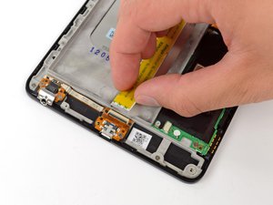

Although it looks like caution tape, the I/O cable isn't stopping us from digging in deeper.
A few more screwdriver twists and the two part I/O set is out.
The Nexus 7 I/O set houses a standard 3.5mm headphone jack and USB port.
