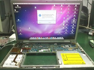

After reading this thread, I came up with a longshot way to solve what seemed to be a bad logic board; I intentionally overheated the computer, while turned upside down.
My MBP 15 A1226 had signs of a bad logic board - the hard disk would sound on, the fan would start up, the MagSafe power indicator light was on, but the computer's 'power indicator light' (the one that normally pulsates when the comp's sleeping) would light up and glow steady, and the screen would remain completely dark and unlit. I tried suggested steps from iFixit, Apple, and macrumors (resetting PRAM, SMC, etc.) and there was no change in the computer's symptoms. This lasted a day.
What seems to have resolved it was this; plugged in the AC power, turned on the computer, closed it, turned it over, then put a folded-up quilt on top of it, and went downstairs and watched Pineapple Express. When I came back to it, I opened it, unplugged it, then turned it off. The power button was extremely hot and the fan was blowing very high. I held it in front of a fan and about a minute later pressed the power button and it booted up like normal.

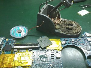

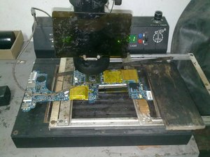

The best solution is to reball or replace the nvidia G84-602-A2 (A1226) and it work. check my work.
This process also works in A1260 using ATI X1600

Hi all! 10/20/2013
I am a Japanese. I translate Japanese into an English sentence by translation software. I am sorry that it is not a correct English sentence. I may not follow a rule by the first contribution, but decide to show courage, and to contribute it.
I show my repair method to everybody. It is unscreened in Japan.
There are two causes not to start.
1.BGA chip
This repair method has been already shown.
2.ceramic condenser
As for the laminated ceramic condenser, deterioration gradually advances. Deterioration has a characteristic becoming faster in the high temperature and humid area.
This laminating ceramic condenser is installed to remove a noise mainly. Economy is lost when I install a lot it, and a PC price rises.
When the deterioration of the laminated ceramic condenser advances, PC movement becomes unstable. Furthermore, a PC does not start when I advance.
In the example "that I did not have any problem until the day before, but did not start the next day", it might rain. When a laminating ceramic condenser becoming the high temperature gets cold, the water-rich air gets inside. Therefore, the capacitance of the laminated ceramic condenser decreases. When capacitance decreases, a CPU does not work normally because a noise becomes big. In other words, it does not start.
The repair due to heat gun is the repair method that is good because the deterioration of the ceramic condenser is improved. However, the PC does not start again several months later.
A radical solution is to add a ceramic condenser to a main board.
I prepare 4-6 condensers of 6.3V100Ī¼F.
The noise of the CPU decreases by adding this to a certain place.
The insulation is heat-resistant, and the one side adhesive tape of superior polyimide is necessary for this work.
I can perform the masking such as boards, protection, the insulation easily. The durability temperature in the practical use reaches around 260 degrees Celsius.
The ceramic condenser block use the solder having high melting point. Work becomes easy by using the solder having low melting point when I attach a ceramic condenser block to a main board.
Even other models think that many problems are solved by similar measures.
Poor IC of TPS51120 attached to the bottom of the right fan is more likely to produce the PC of a no power. Only a high engineer can change skill.
Finally there is a request from me.
You purchase new mac, and it is free or is inexpensive and provides it to people who cannot purchase mac where repair ended in, and let's open mac world.
The thing which is not broken is not a product forever. The controlled dissatisfaction promotes the purchase of a new product.
I pray for good luck visiting all of you to see this.
I add a postscript to a sentence 10/22/2013
My repair method only heats GPU.
A thing to set up is a solder flux.
1. I pour a solder flux around GPU.
2. I wait for 2-3 minutes until a solder flux attaches to the whole GPU.
3. Because an extra flux flows out when I make an air blow around GPU, I wipe this off
4. I heat GPU for a heat gun.
5. The temperature of the GPU circumference seems to reach it to around 190-200 degrees Celsius and adjusts the position of heat gun with an infrared thermometer. Because parts of the back side drop when I heat more than 200 degrees Celsius, I am careful.
6. If it becomes 200 degrees Celsius and passes for 30 seconds, I make a heat gun a ventilation mode.
7. I wait to turn off a heat gun, and to fall to normal temperature.
8. I install it again
It is the best method to change GPU. However, I may repair even this method.
