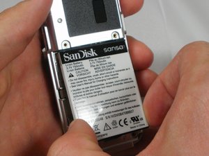

The Sansa e260R was released by SanDisk as a high-capacity flash player in 2006. It can hold music, video and photo files and as a member of the e200R series, it has Rhapsody support and the ability to play WMA and RAX ACC files. This device includes a removable battery, a Micro SD expansion slot and a 1.8 inch color screen. The small, sleek design that provides a user-friendly interface is a strong competitor in the media player market.
Identification
On the back of the Sansa e260R is a series of engravings reading SanDisk, 4.0 GB, and Sansa. The trait that differs between the Sansa e260 and the e260R is the Rhapsody engraving on the back. Also identified by model number SDMX4-4096-A70.
