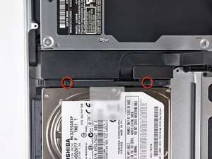

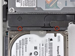

Remove the two Phillips screws securing the hard drive bracket to the upper case.
These screws are captive in the hard drive bracket.
Remove the hard drive bracket from the upper case.
