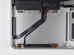

Remove the following four screws securing the hard drive and IR sensor cable to the upper case:
Two 1.5 mm Phillips screws.
Two 4 mm Phillips screws.
