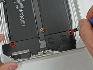

Remove the two 2.84 mm T5 Torx screws securing the speaker assembly to the rear panel assembly.
Remove the single T5 Torx screw securing the middle of the dock cable to the rear panel assembly.
