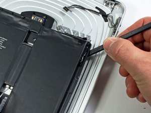

The battery is held to the rear panel by an excessive amount of adhesive. Proceed with patience and caution.
Use the flat end of a spudger to gently pry the battery up from the the lower case.
Gently continue to enlarge the gap by wiggling the spudger and running it along the right side of the battery.
Continue to pry until the right side of the battery is free from the rear panel.
