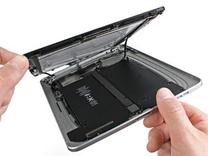

Insert a metal spudger between the top edge of the display assembly and the rear panel assembly.
Rotate the spudger away from you to release the tabs along the top edge of the display.
Insert a second metal spudger between the top edge of the display assembly and the rear panel assembly to keep the tabs from snapping back into place.
